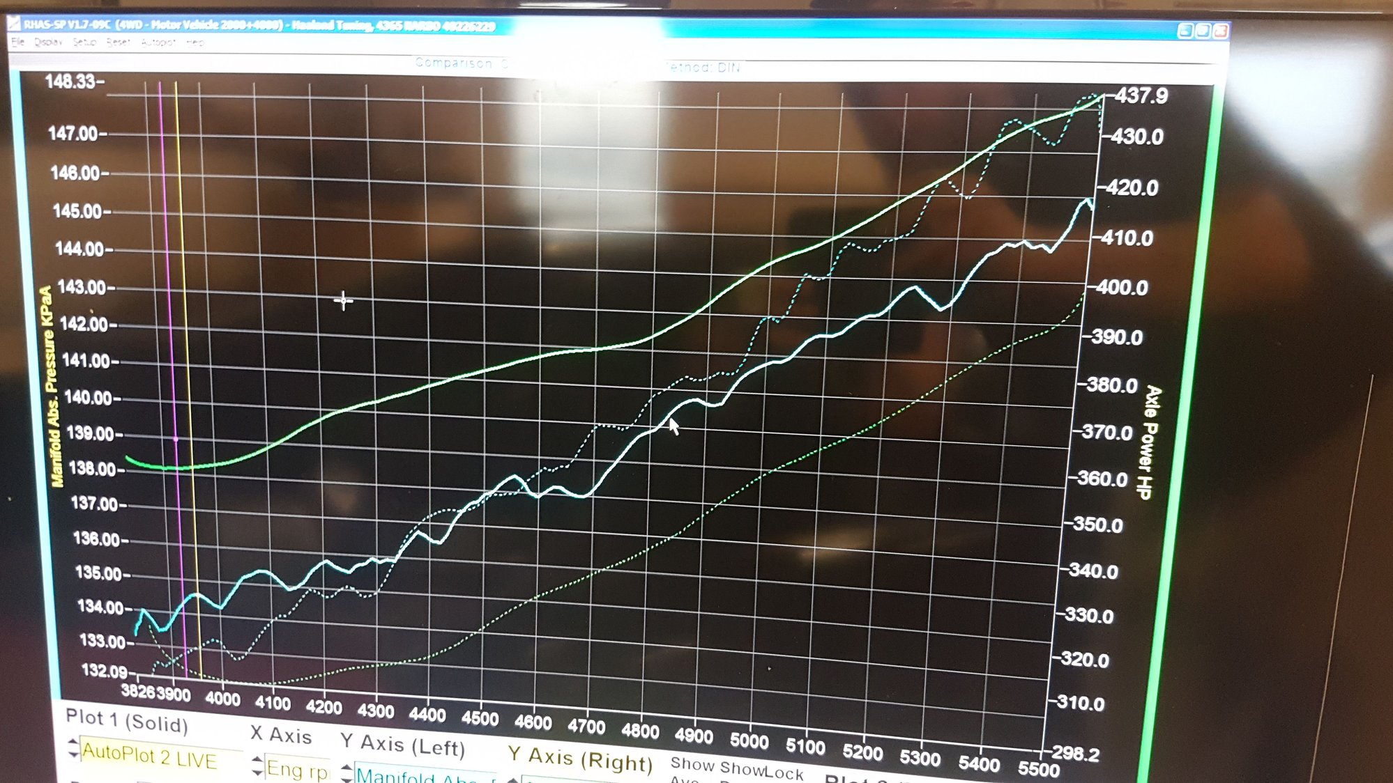

Went to dyno it and it made 330whp at 5500rpm blowing off my 3" exhaust due to backpressure. Taking off the exhaust and air filter it made 440whp at the same rpm, untuned.

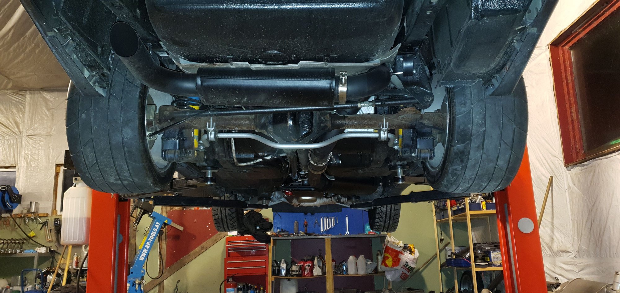

I took it home and made a new 3,5" exhaust and fitted a bigger airfilter. Car performed good the rest of the season spinng first and second street on a roll.

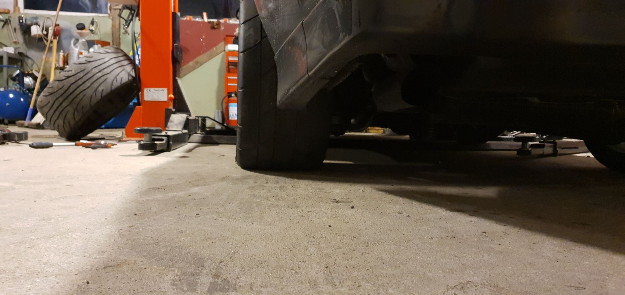

I bought a used set of 17" corvette rims with 315 mt et street tires, trying to get some grip. Testing in november on dirty cold country roads without a burnout i managed 2 second 60fot using dragy for measuring.

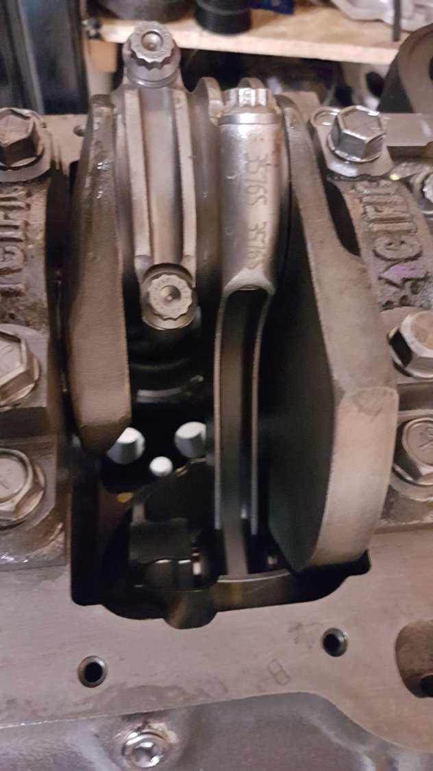

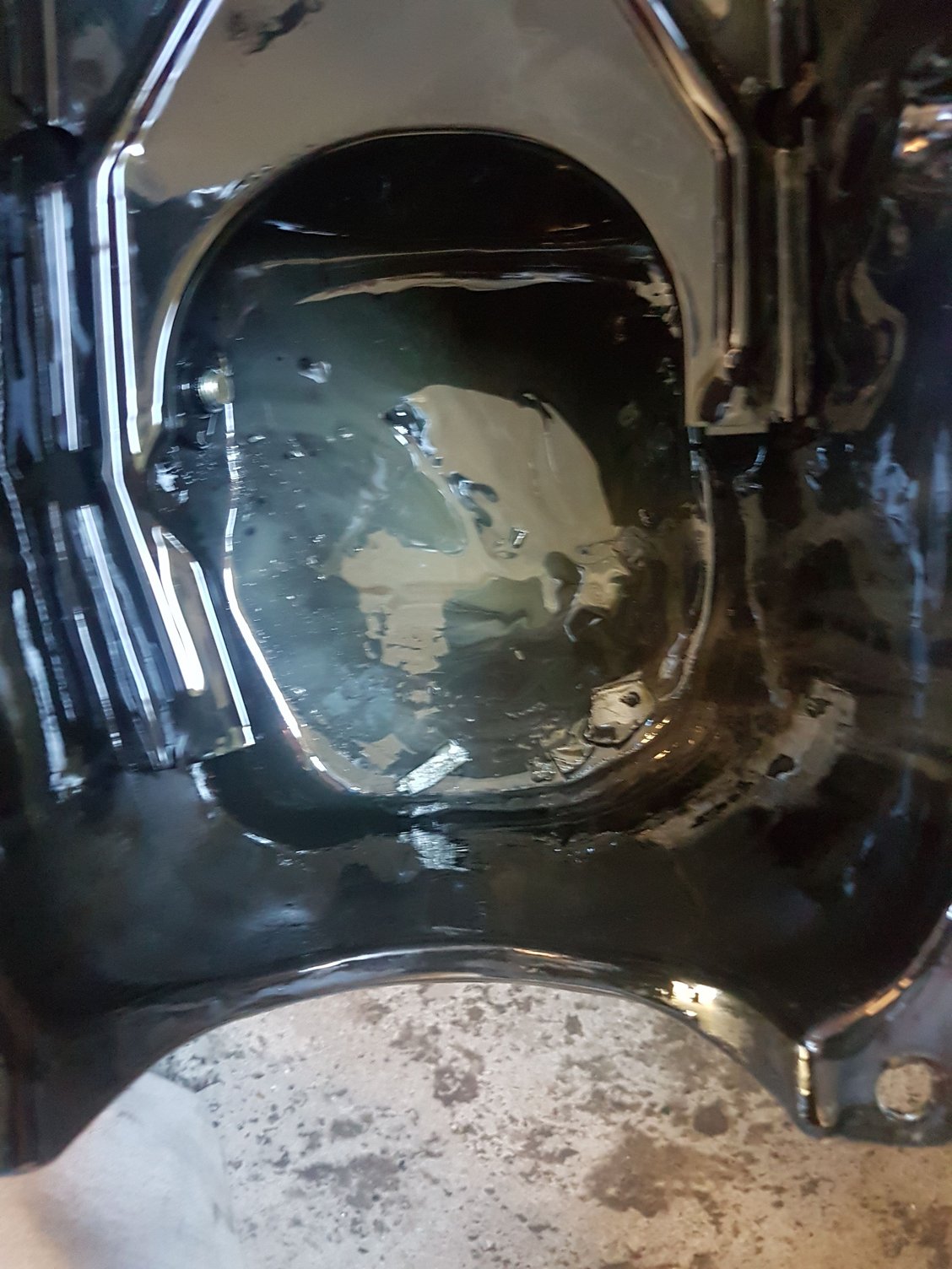

Some pictures of the broken engine.
I then decided to buy a new bottom end.

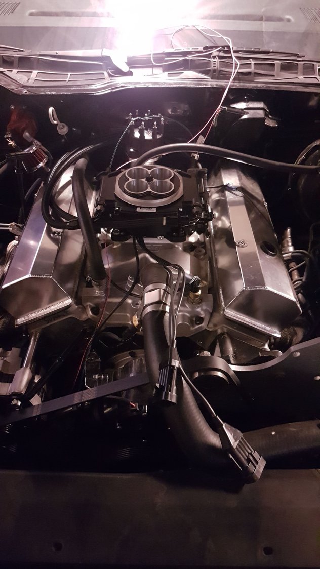

and new heads

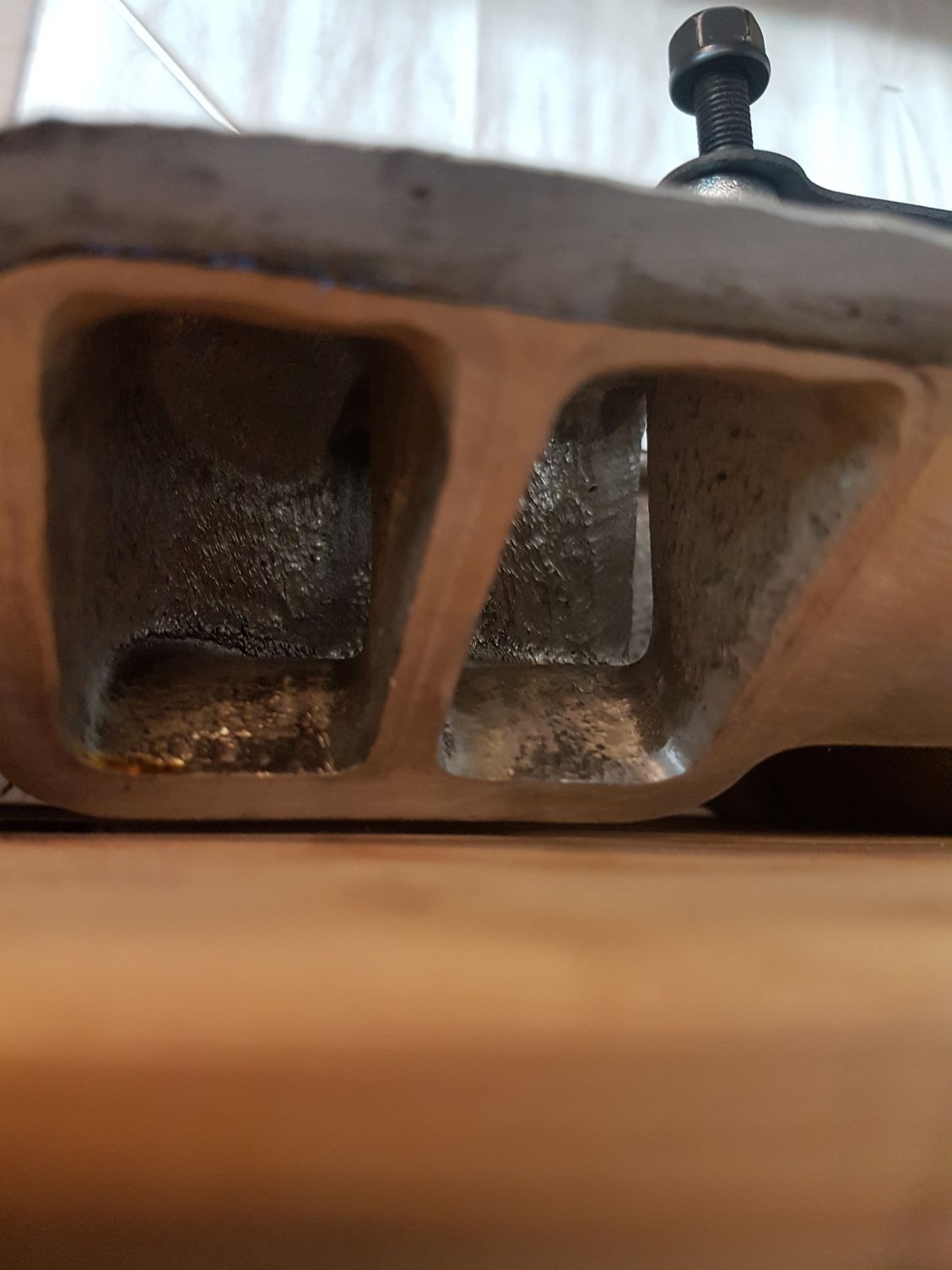

I have ported and reworked the runners of the intake myself, had to ad some more material so it could be ported out to 1206 gasket
Dyno run letting off early and un tuned

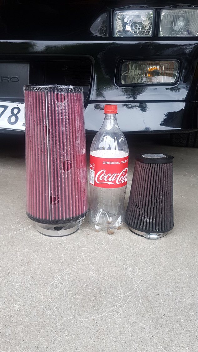

Had to get a bigger air filter, this was the biggest i could fit. Supposed to be good to 950hp. Old filter and 1.5litre bottle to compare.
And some new rear wheels to get some more grip

sweet car, but the 3" exhaust having too much backpressure seems strange... my 4th gen ls1 car made around 400whp with a stock 3" slp dual/dual exhaust.

Actually it was a single 3" straight pipe from the headers back to a single 2,5" entry dual exit rear silencer. I had a 3" electric cut out in the front that i was going to open after, but the exhaust was a bigger restriction than i liked so went with a new one.
