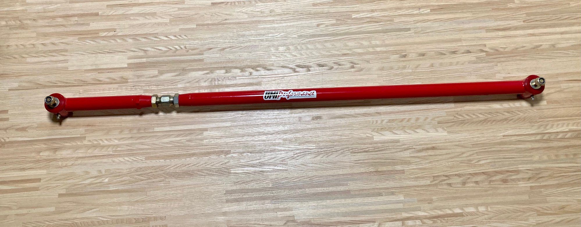

Yeah, staying active with the rear suspension upgrades…
USED Panhard Bar $110.25 and Nuts & Bolts $20.69
Sway Bar End Links $27.55

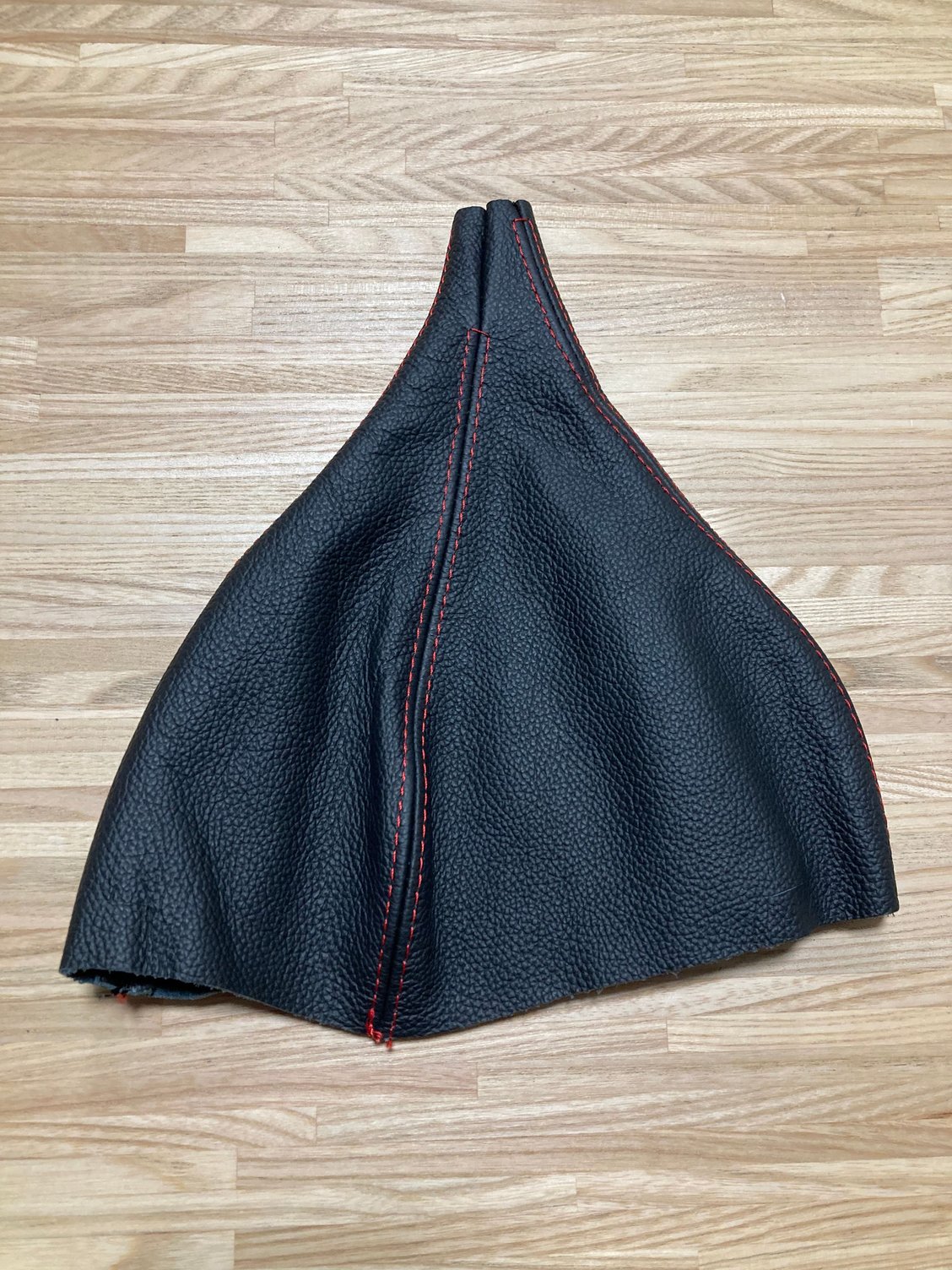

Hurst Billet Competition Shifter is breaking-in nicely! Replaced the OEM vinyl Shift Boot with a leather version from The Tuning Shop in the UK. The Rubber Shift Boot and Screws that seal the floor were also replaced. Considered an additional Rubber Shift Boot to minimize heat but will reconsider that when replacing the Carpet.
2001 Camaro SS Center Console is from my first Trans AM, a 1990. I'll need to modify the Window Switches to fit into the Ash Tray or extend the wiring to reach the Storage Area above the Shifter...
Shift Boot $35.77 & Shift Boot Ring (not pictured) $9.42
Shift Boot $49.99
Hurst Emblem $16.68

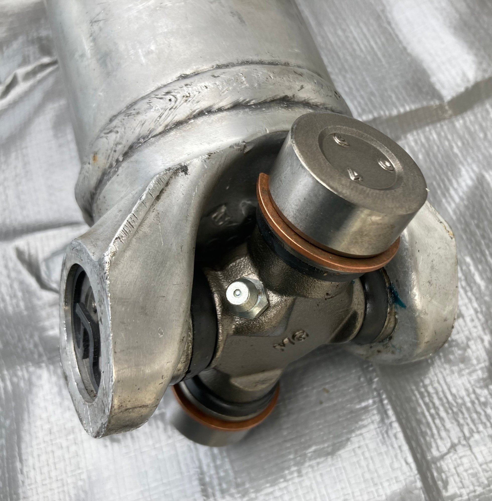

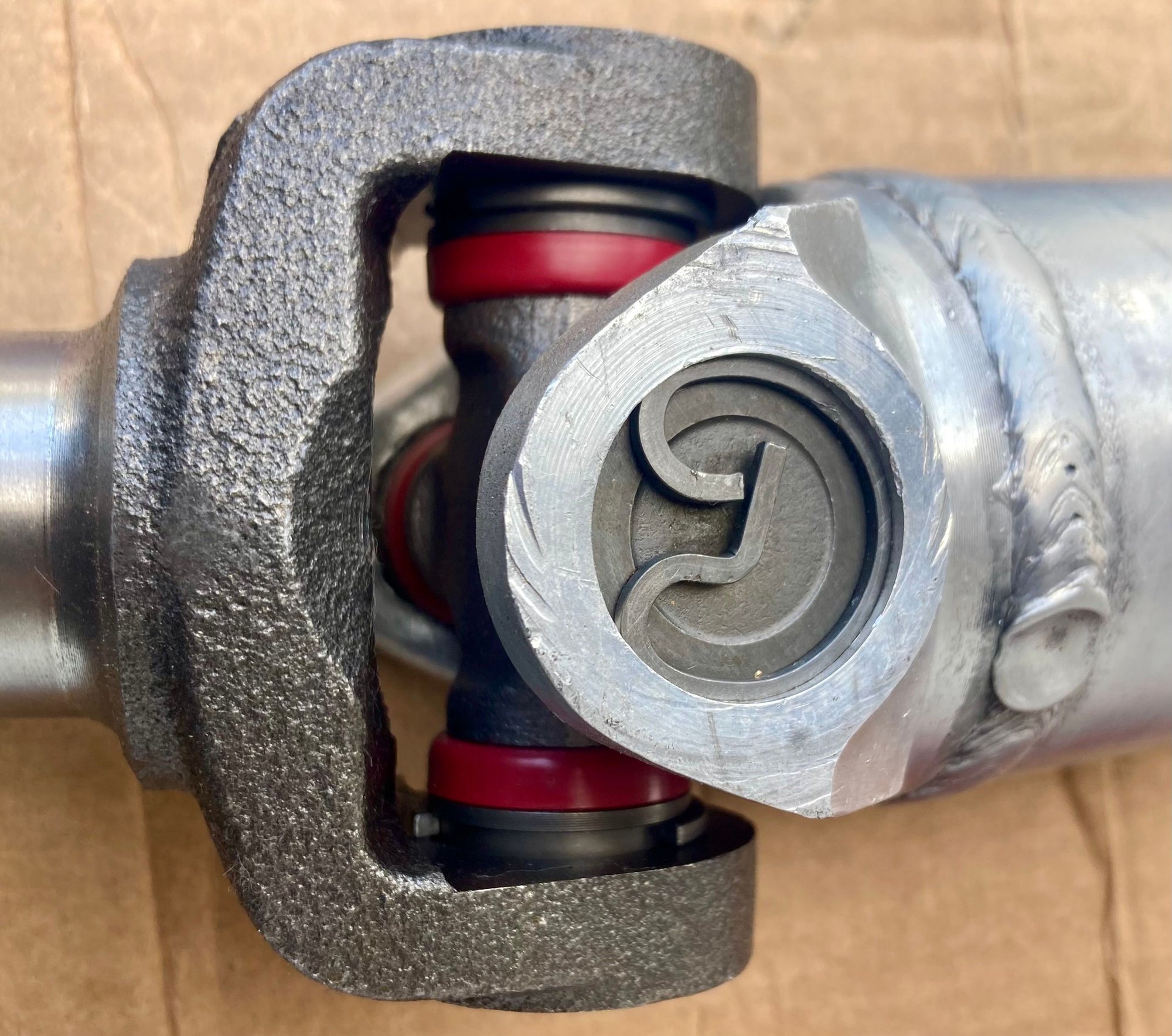

Back in the day, circa 2012 to be exact... I purchased an Aluminum Drive Shaft from TGO for my first Trans AM, a 1990 which was never installed so Ive rebuilt it for use on this vehicle.
California F/S Aluminum Drive Shaft - Third Generation F-Body Message Boards
USED Drive Shaft $80.00
Slip Yoke $136.70
Labor $133.08 @ Performance 4 Wheel Drive
U-Joint $0.00 (AutoZone Rewards)
U-Joint $
U-Joint $42.95

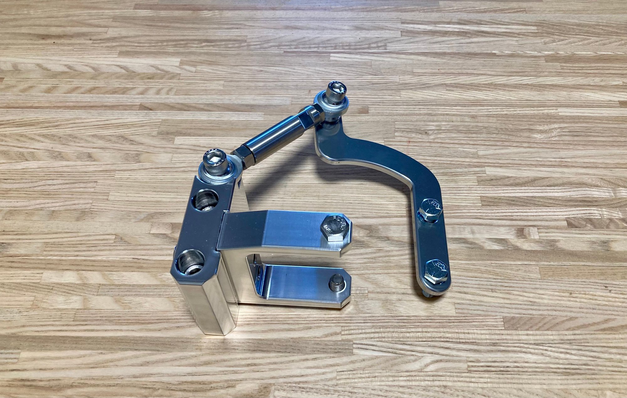

Replacing the Power Steering Bracket from Post #40
Power Steering Bracket $131.19 & replacement Bolts $2.58

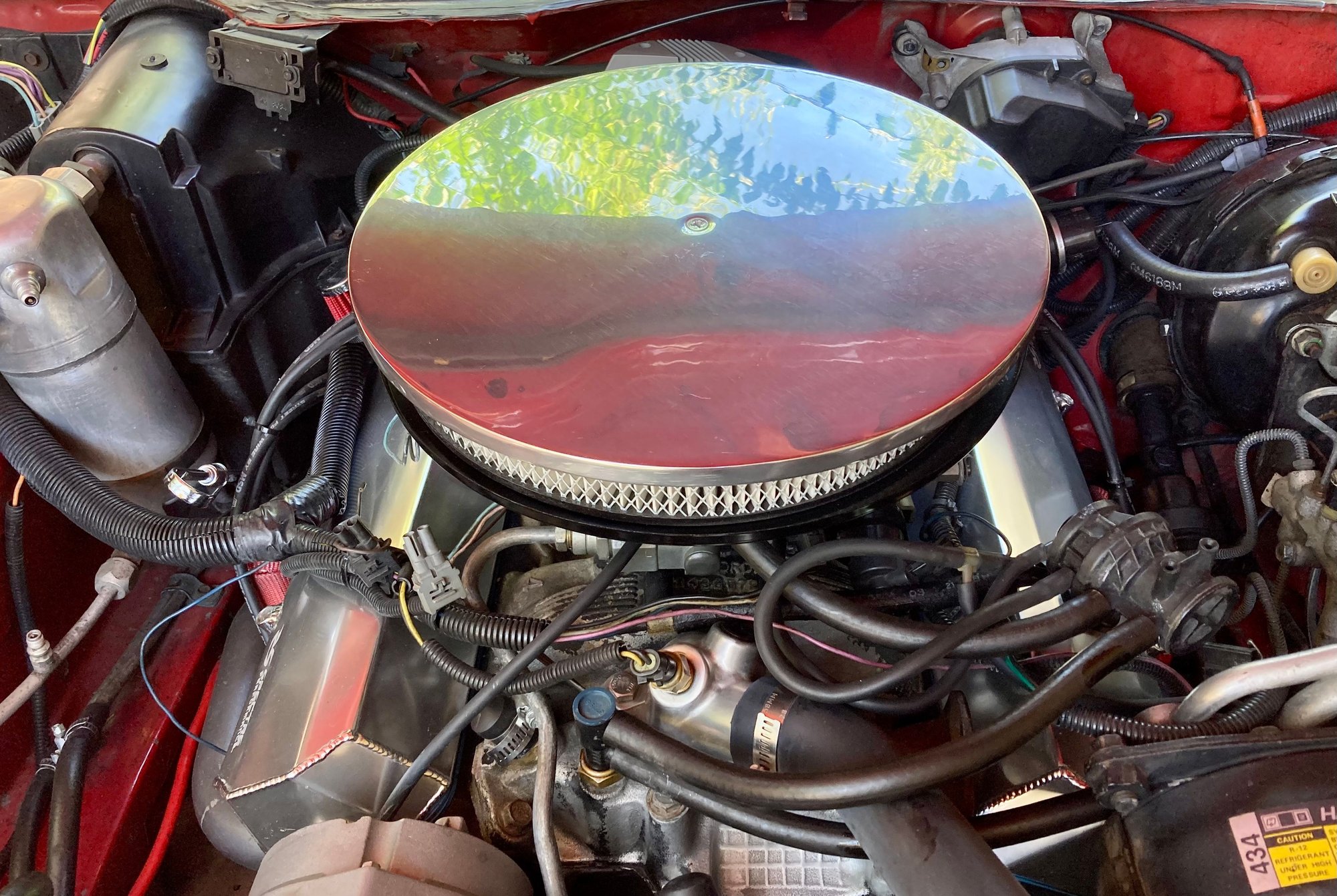

An Aluminum Air Cleaner Lid to accentuate the Aluminum Valve Covers.
Air Cleaner Assembly $62.83 & Air Filter $14.32

This is picking nits here but your MAP sensor is mounted incorrectly on the firewall/cowl. The screws need to go through the holes on the side of the sensor where the electrical connector is at. This style of MAP sensor is meant to be mounted with the vacuum nipple facing down so that any combustion gases lingering in the sensor element area will come back down the nipple and into the vacuum hose when the engine is shut off so as to not foul the sensor element.
If you mounted it that way for looks to hide the wiring some then A-OK.

Quote: This is picking nits here but your MAP sensor is mounted incorrectly on the firewall/cowl. The screws need to go through the holes on the side of the sensor where the electrical connector is at. This style of MAP sensor is meant to be mounted with the vacuum nipple facing down so that any combustion gases lingering in the sensor element area will come back down the nipple and into the vacuum hose when the engine is shut off so as to not foul the sensor element.
Someone else mentioned this exact same thing on another one of my Firebird's but I'm almost certain it's OEM...

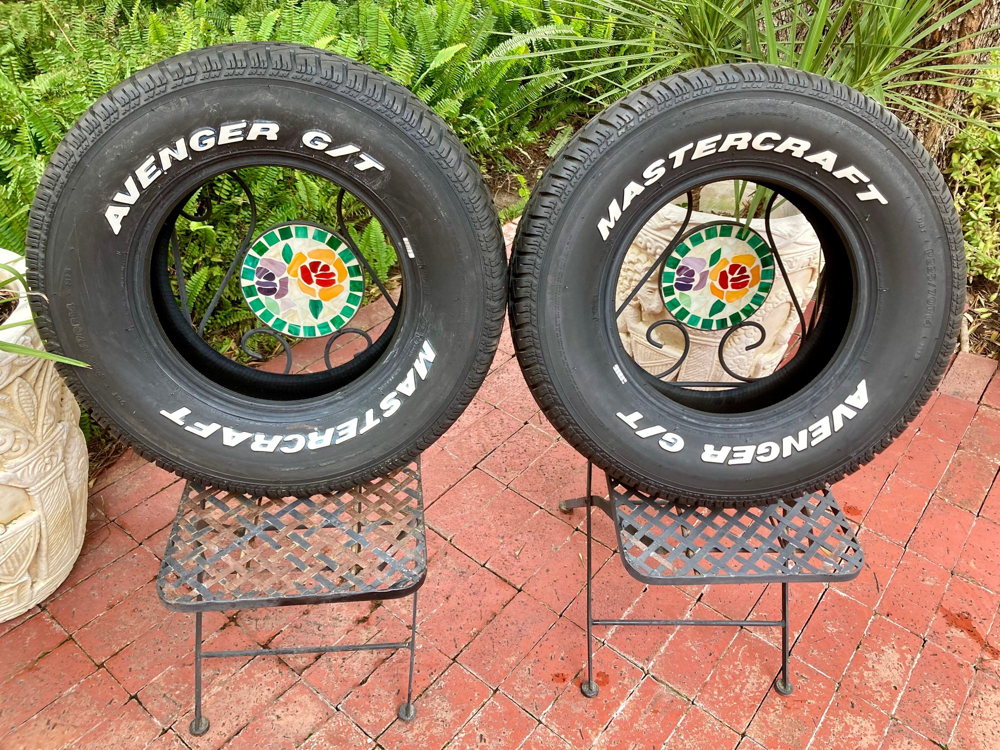

Switching to 225/70/14 VS 195/65/14 for more drive-ability.
Front Tires $249.20, Mounting & Balancing $50.00
Reply 0

Your running 14's ?
Reply 0
Sep 17, 2024 | 05:26 PM
  #78
Re: 1985 Trans AM w T-Tops & 5-Speed Manual
Quote: Your running 14's ?
Yeah, the GM N64 aluminum spare option
Reply 0

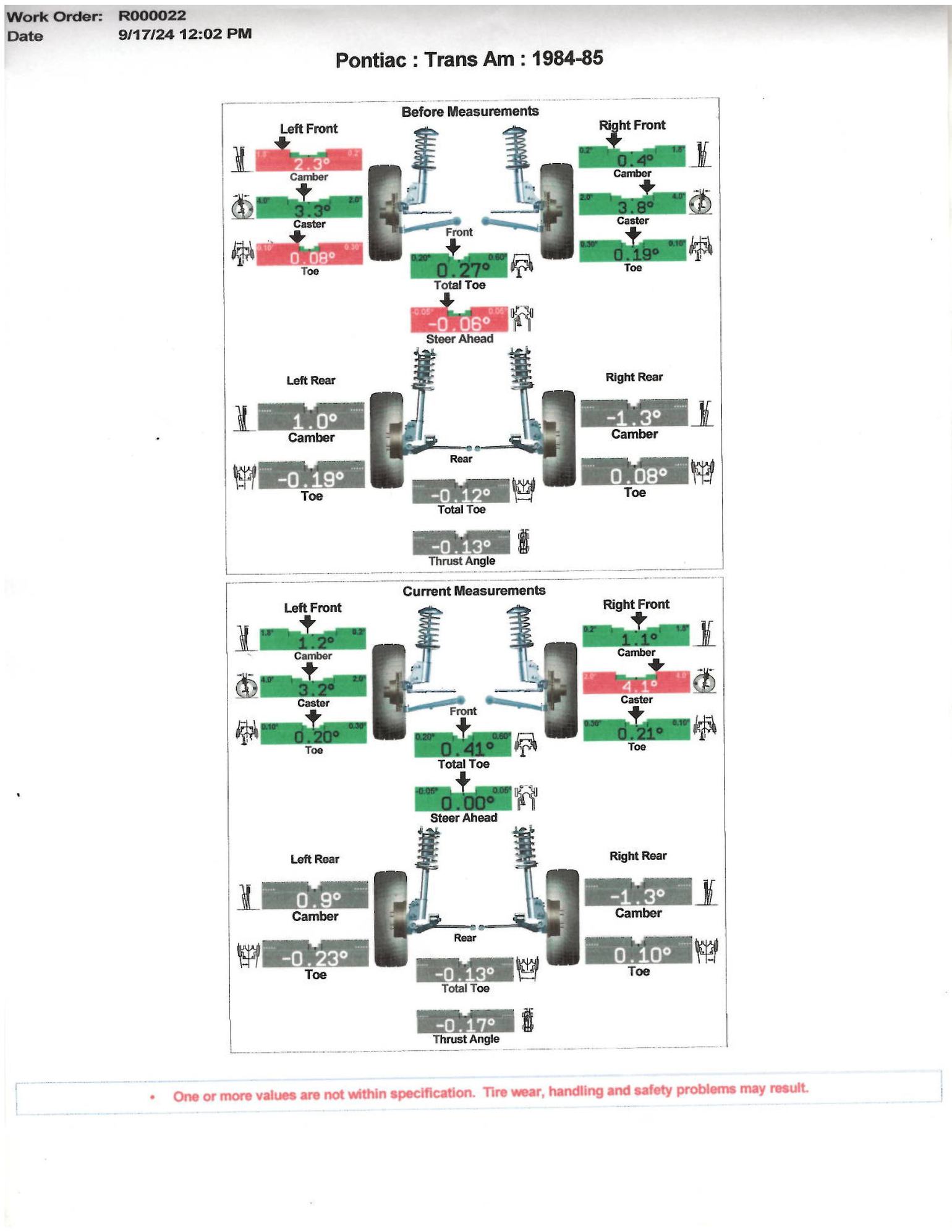

Alignment $83.60

With the amount of sideway on those tires she should ride smooth as a cloud out on the road.
Reply 0
Sep 17, 2024 | 08:50 PM
  #81
Thats a lotta tire for that little wheel.

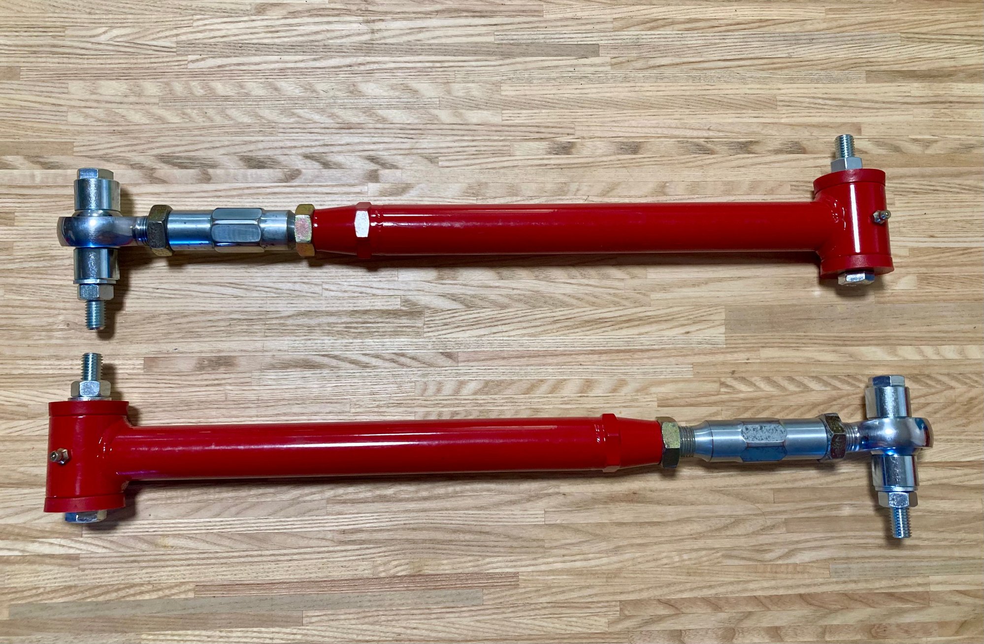

Purchased from eBay; a set of spacers for the Rod End was missing so I replaced both sets.
USED Single-adjustable Lower Control Arms $110.25, Spacers for Rod Ends $8.00, Bolts/Nuts and Washers $22.80

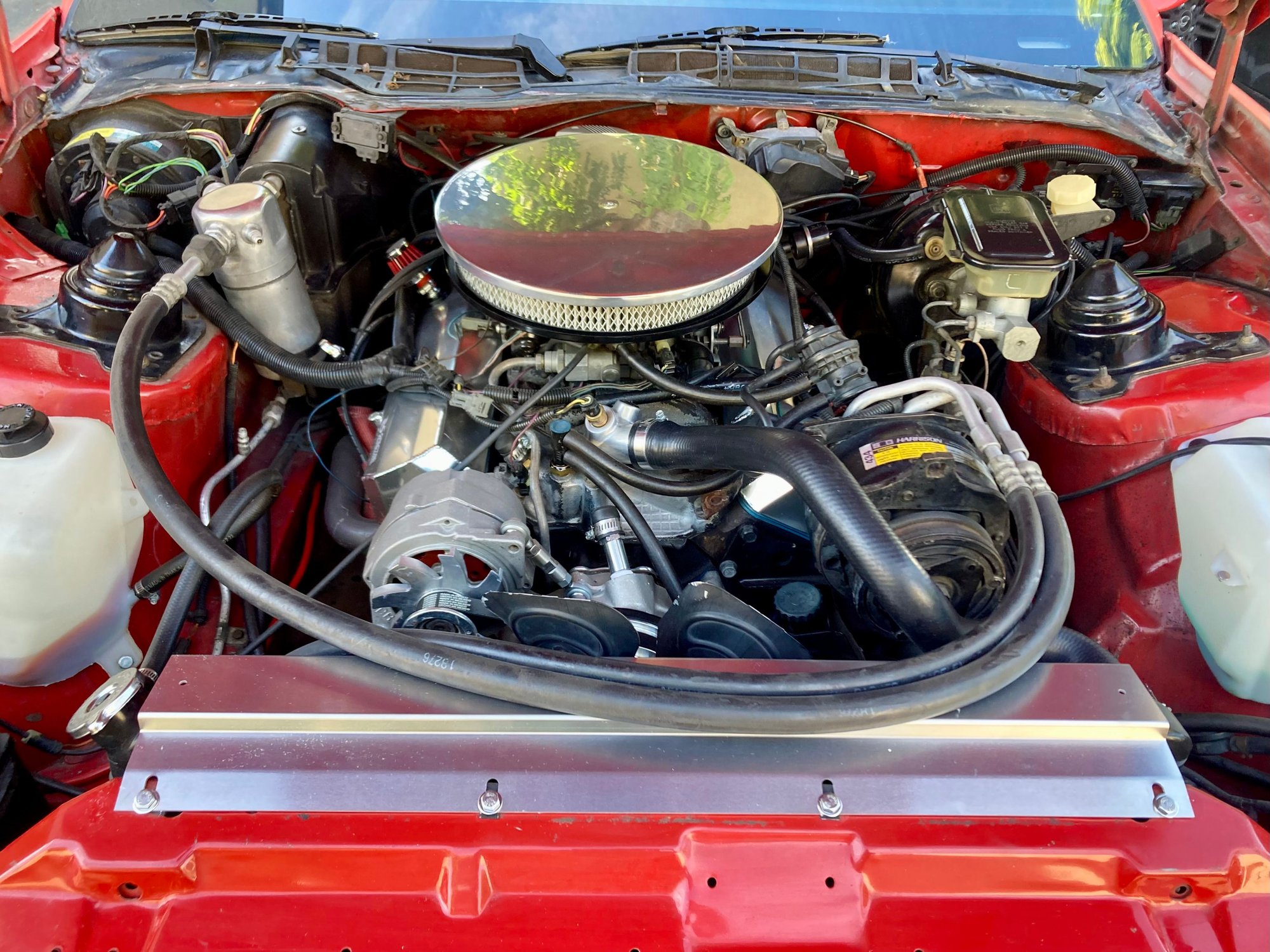

Heavy-duty 14 gauge 5052 aluminum, it's a nice addition to the engine bay. I'll have to wrap the A/C Lines or something...
Bolts $3.48, Washers $1.46, Speed Nuts $8.80, Radiator Bushings $24.12 & Radiator Upper Support Bracket $98.12
Bolts $3.48, Washers $1.46, Speed Nuts $8.80, Upper Radiator Hose $22.04, Radiator Bushings $24.12 & Radiator Upper Support Bracket $98.12,

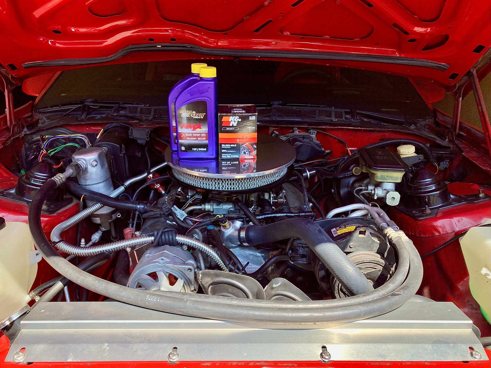

Oil & Filter @ 159,410mi for $35.83

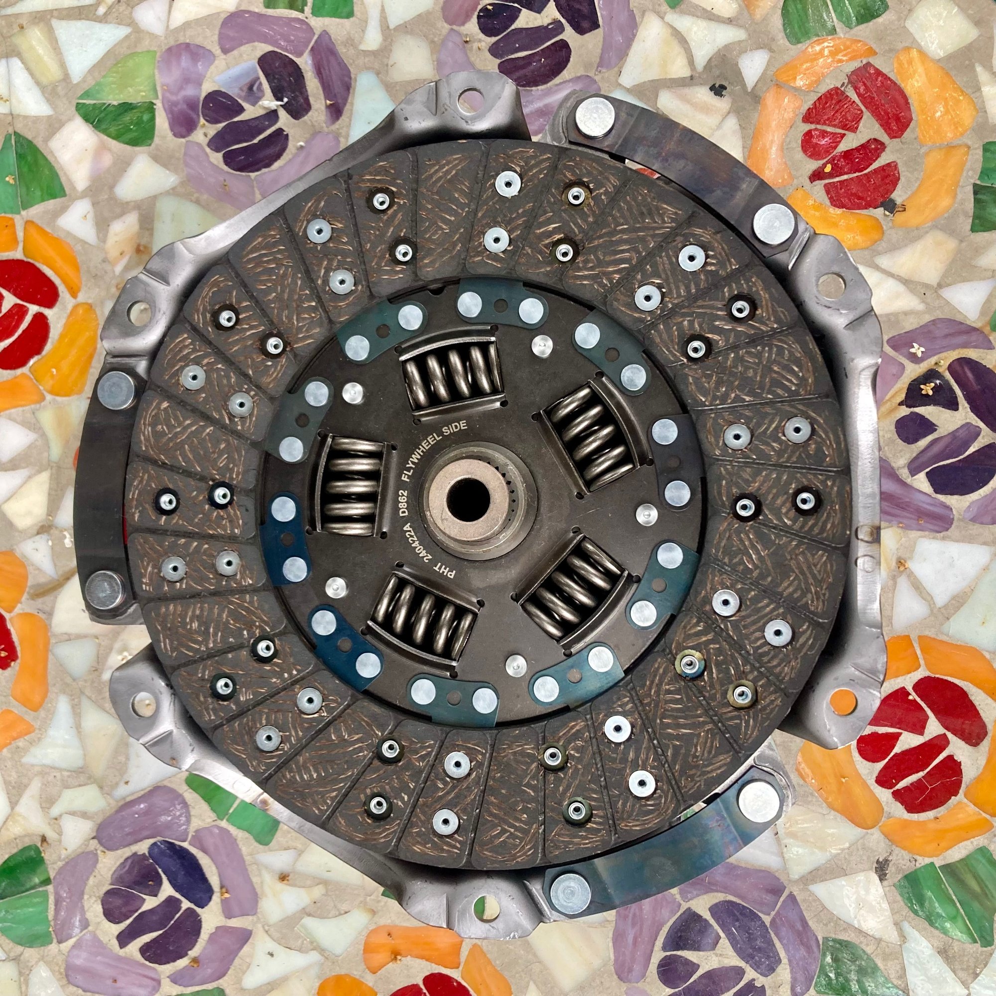

Scored a lightweight flywheel from RockAuto on "Wholesaler Closeout"
Paired it with a ZOOM Performance Clutch Set. Labor was performed by Express Auto Repair in Bellflower, CA.
Labor $425.00
Header Gaskets $40.00
Exhaust Gaskets $20.00
Clutch Master Cylinder $55.00
Clutch Set & Flywheel $228.29
Clutch Set $228.29
Flywheel $

Oil & Filter Service @ 60,218Mi for $47.47

You're in Southern California and don't have a proper fan shroud.
How can you NOT be overheating?
Reply 0
Jun 16, 2025 | 12:50 AM
  #100
Quote: You're in Southern California and don't have a proper fan shroud.
No Upper Fan Shroud but I do have the Lower Fan Shroud + Heavy Duty Water Pump (post #22) + 160F Thermostat (post #21) + Heavy Duty Fan Clutch (post #32) even though it hasn’t been hot but I’ll keep y’all updated for Summer 2025
