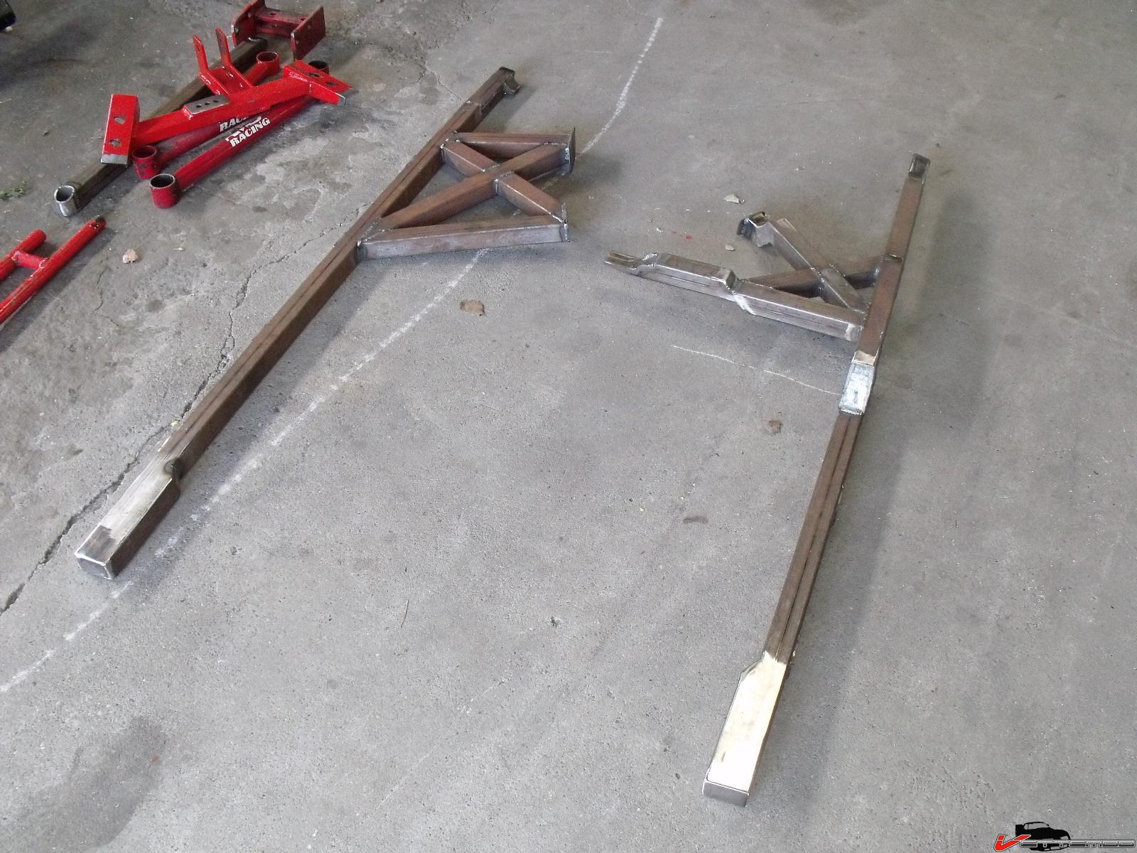

I vote for build your own. That is what i did...

BTW.. to fueledsoul: Holy stiffness, Batman!
How much do those bad boys weigh?

Re: SFC comparison thread
46lbs

yeah fueled badass... i wonder how the weight stacks up against comparable aftermarket connectors...

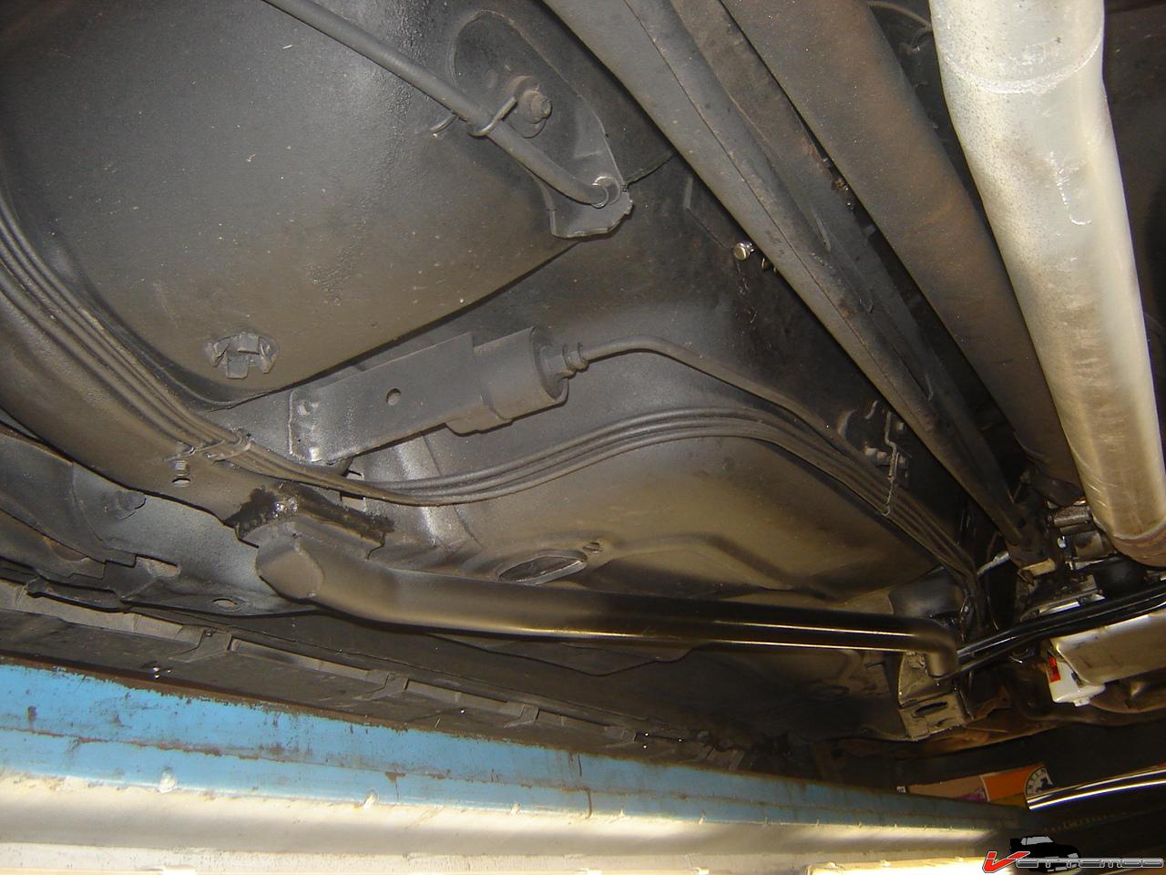

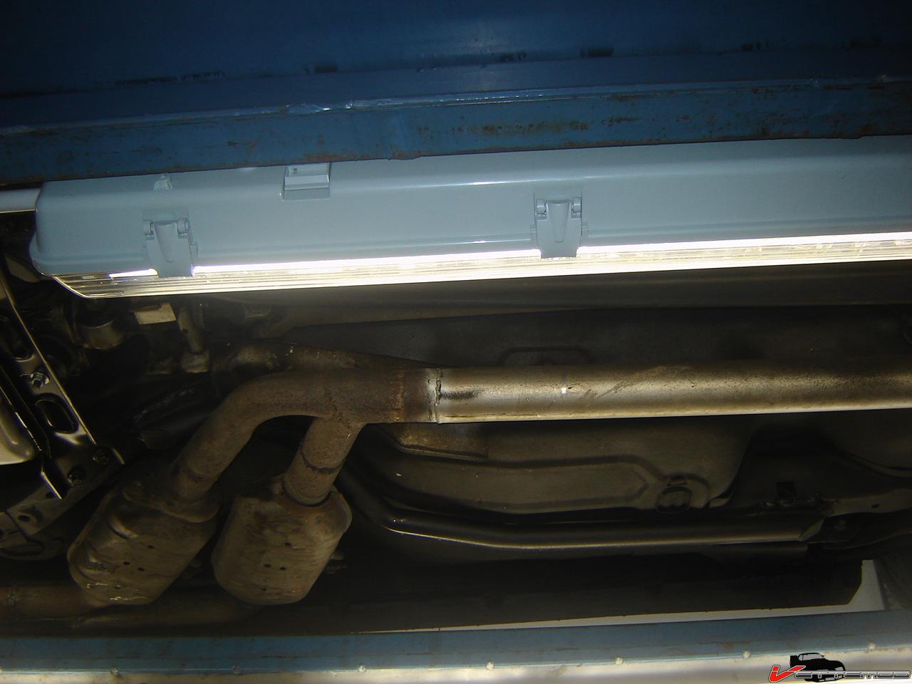

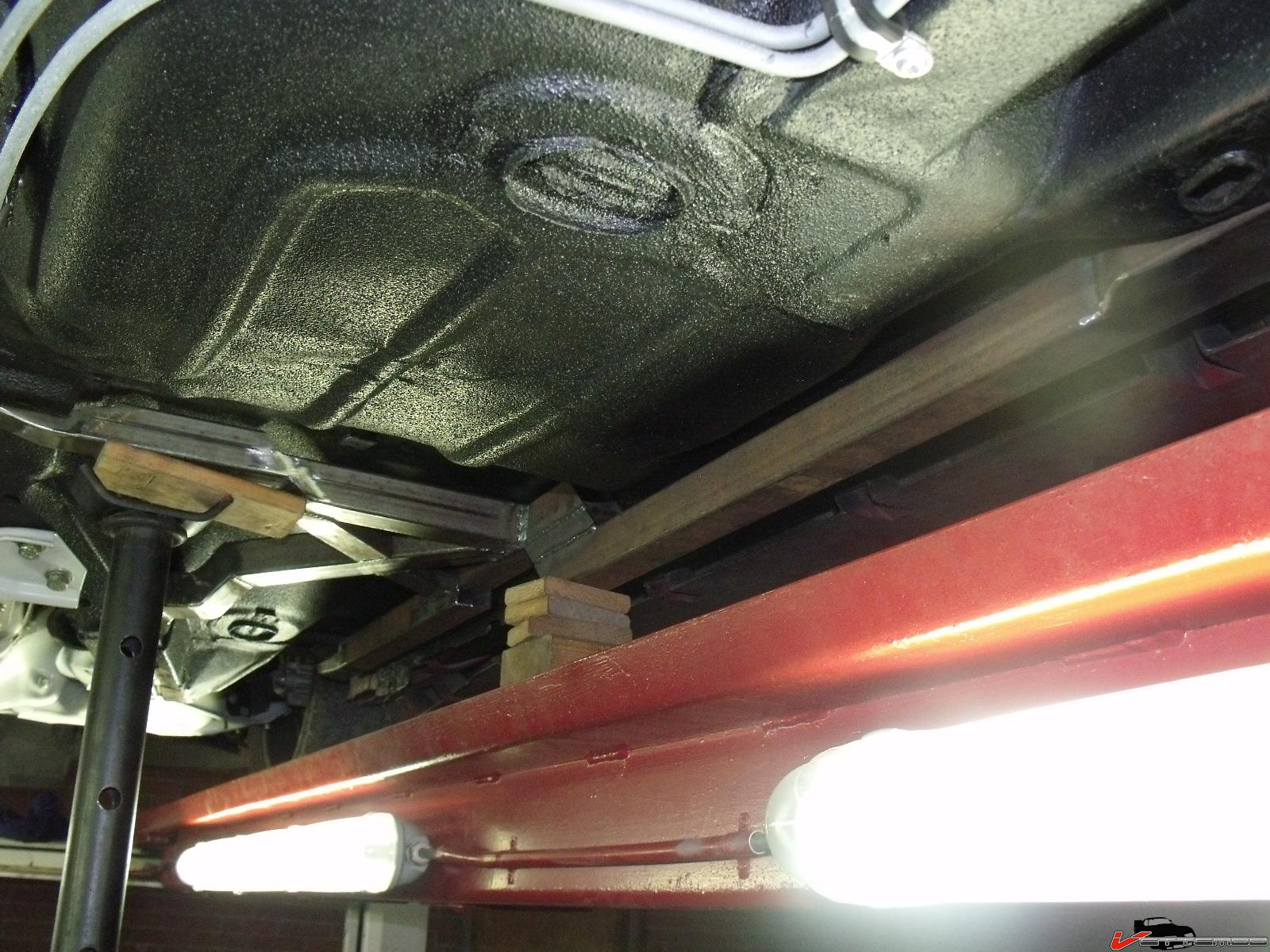

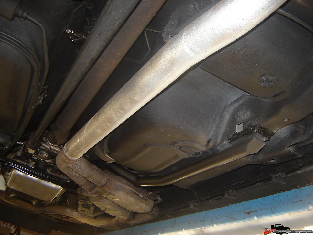

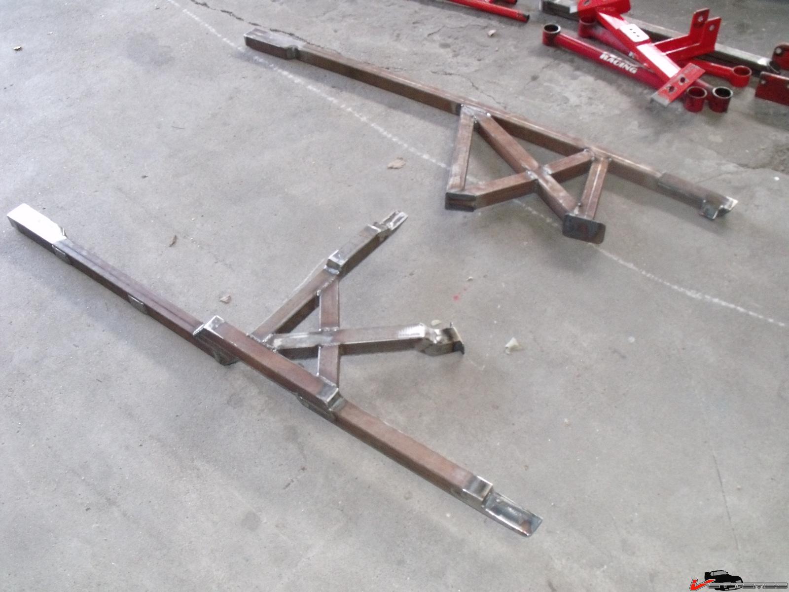

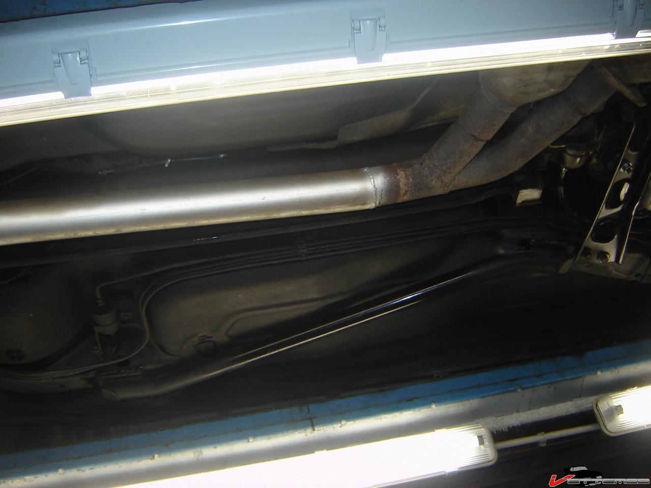

Old Sep 7, 2011 | 04:08 PM
Twin_Turbo's Avatar
iTrader: (25)
Joined: Jun 2000
Posts: 5,364
Likes: 51
From: Enschede, Netherlands
Here's mine, because of how low my car is and the way the exhaust runs I couldn't do the mac/alston sections like fueledsould did. Otherwise I would have, I have those on my 88 and it scrapes but not too badly.

nice man wish i had the skills/tolls to do that! are they around 65lbs as well?
Old Sep 8, 2011 | 05:06 AM
Twin_Turbo's Avatar
iTrader: (25)
Joined: Jun 2000
Posts: 5,364
Likes: 51
Have to weigh but from holding them, I'd say they were more around 50
any pics of these custom ones installed
Old Sep 8, 2011 | 06:20 AM
  #42
Twin_Turbo's Avatar
iTrader: (25)
Joined: Jun 2000
Posts: 5,364
Likes: 51
Old Sep 8, 2011 | 06:59 AM
  #43
lunati397's Avatar
Joined: Mar 2004
Posts: 773
From: Clovis NM
Car: 2012 F350 lariot/1991 Camaro RS
Engine: Powerstroke/6.0
Transmission: 6R100/4L80e
Axle/Gears: 3.73/3.42
that was fast thanks it puts them in perspective better
