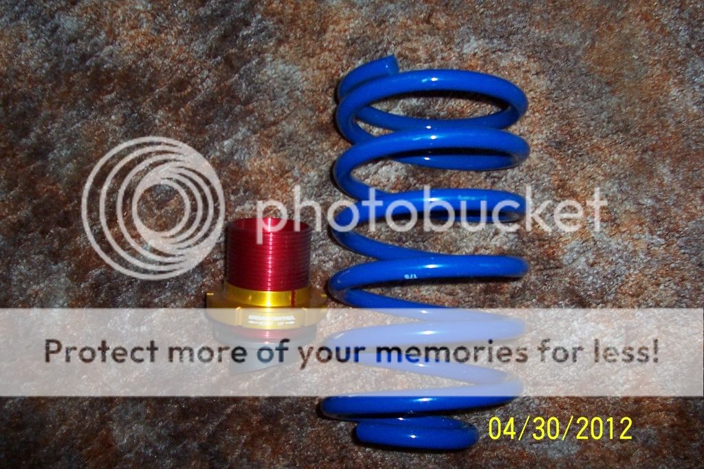

However I had already thought about that and basically purchased it and installed it about 4 days ago. Turned out pretty good.
I got speedways hidden adjustment shim with 2.5" of adjustment. Then I got 11"tall by 5" AFCO 200lb springs. I used a 1/2" poly spacer/isolator at the top of the spring. Basically made my own weight jacks. Worked out fine so far. The springs altho much shorter than stock still give me a good bit of wheel gap (perfect for the drag radials) however I adjusted them all the way down and they are close to where my cut moog 5665s are. If i remove the top isolator I could gain 1/2" to lower my ride. I could have gotten away with a cheaper 10.5"x5" "truecoil" spring at about 46$ each.
Cost was about 160$ to my door and I could have saved alil by going with a different brand but they were about 52$ each.
heres a few pics.
heres a few pics.
heres a few pics.
heres a few pics.

weight on the springs and even then they are kinda tough to adjust. I thought about adding notches and making a tool to help (like a spanner wrench) with that but like I said I haven’t messed with the ride height in years.

yup, no issues! I haven’t messed with the ride height in a few years and have put over 5k miles and they haven’t moved. In order to move them you basically need to jack up the car and remove all
