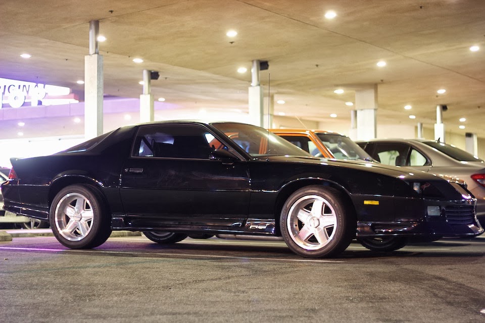

Installed my Founder's Camber plates...
So far, they're great. No additional road noise or anything else has changed, it feels the same; however I was able to achieve caster and camber levels that I could not get before.
Before I maxed out at almost -0.6 degrees camber and 4.5 degrees caster.
Now I have -1.1 and 5 degrees caster, which is exactly what I wanted.
Also, they look great. They kind of go against my stock appearance mod scheme, but the functionality these offer more than makes up for it.

i looks like you are at about -3* camber. a lil more camber than i would run on the street unless you like buying tires.

It looks like that, but the computer showed it as -1.1 degrees.
Very interesting. i have the same ones on mine and that far over is -3*. Maybe ride height is the difference. Oh well, hope you enjoy yours as much as i like mine.

How low are you riding? I'm at stock height with Moog 5662's & Moog CC635's.
