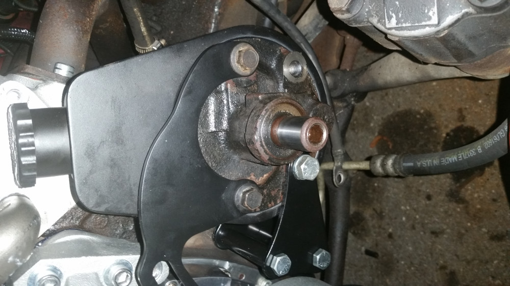

when I say I modified the reservior on the pump, all I did was added the hole on the rh side like most other saganaw pumps have and used the existing threaded boss/added the correct o-ring seal, nothing special. I think I can just buy an '80's/90's truck pump and get the hole already there. The reason I bothered swapping is because I had 3 good (no more) 3rd gen pumps sitting around.
this is what my bracket looks like and why I needed to add that hole so I could use the boss..

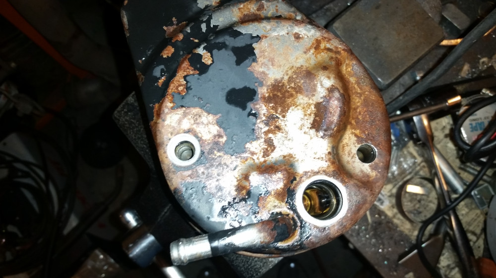

Autopsy of the "dead" pump, I believe that this is the second pump that was in there (out of an '83 TA, I believe that this one is factory original with ~150K miles on it).
I see a little bit of wear from its age, no trash (what you see in the pics are artifacts from the flash and dust from me disassembling), the o-rings are all in place, nothing was leaking all the veins are free...
So what made this stop working after a few miles???
