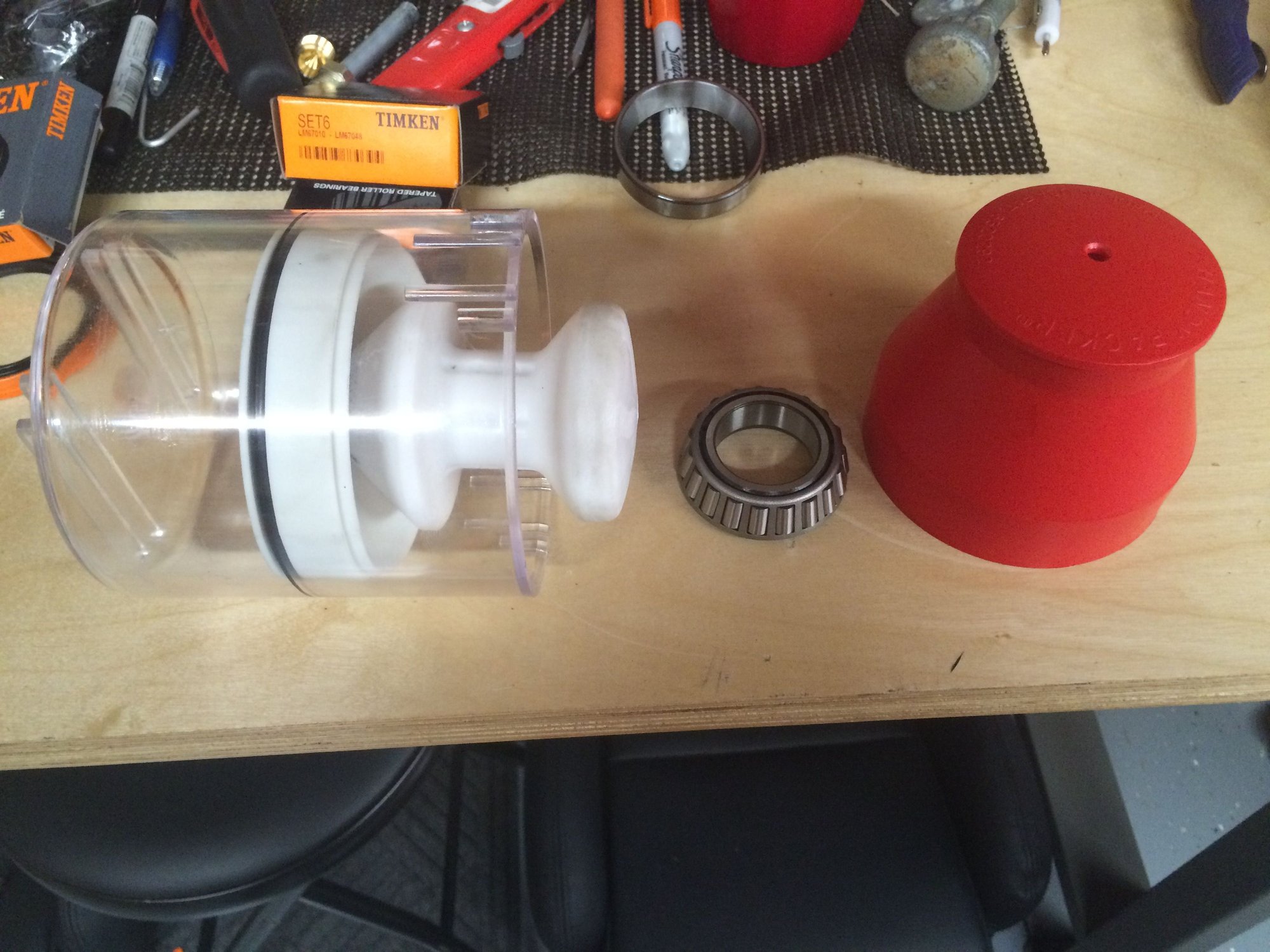

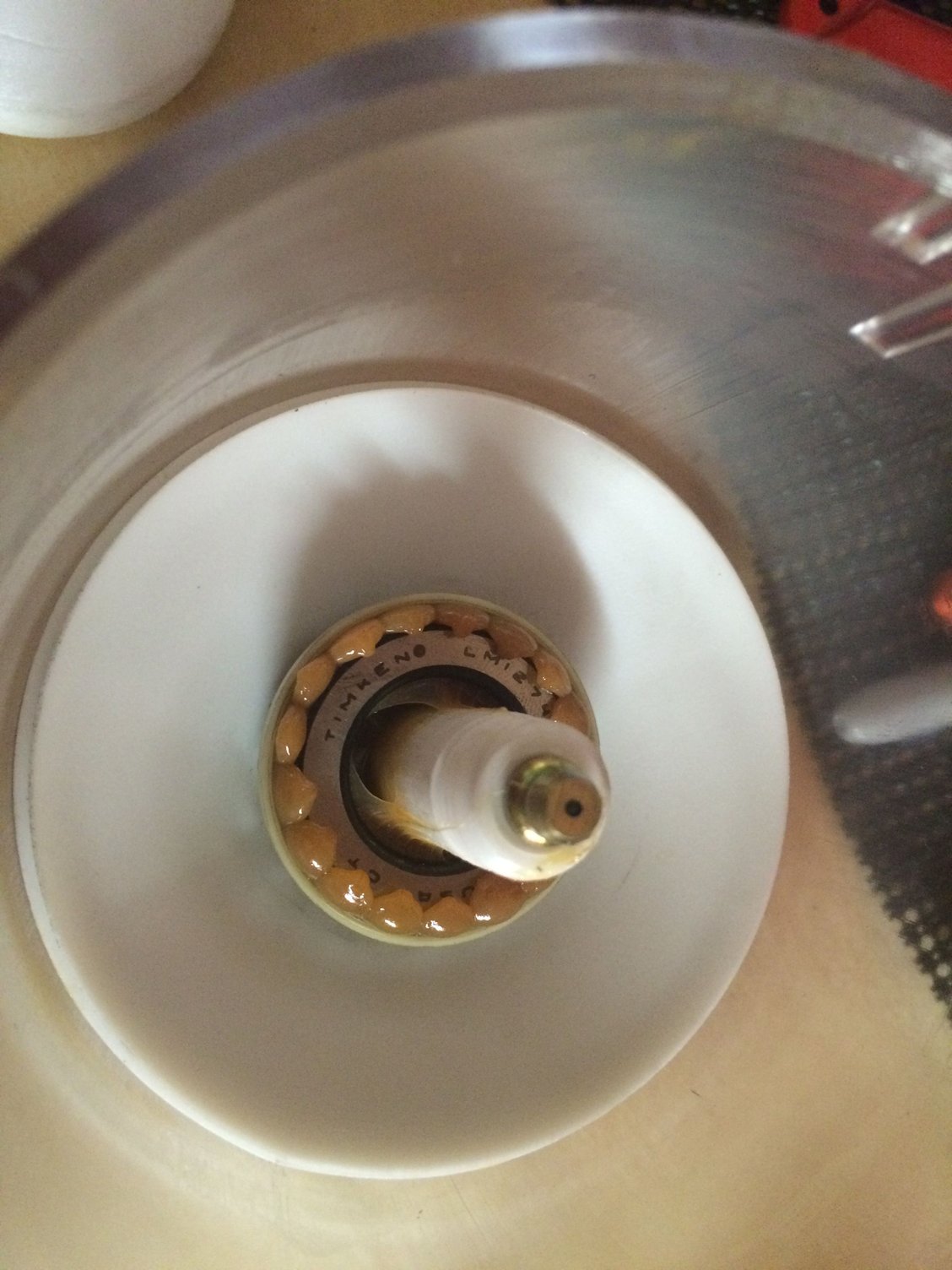

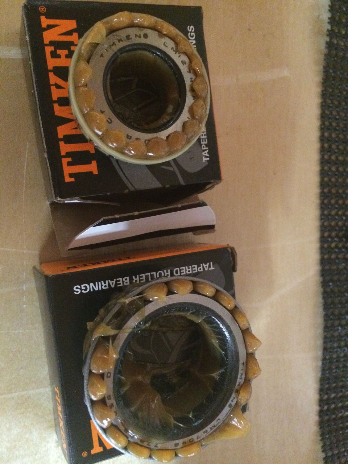

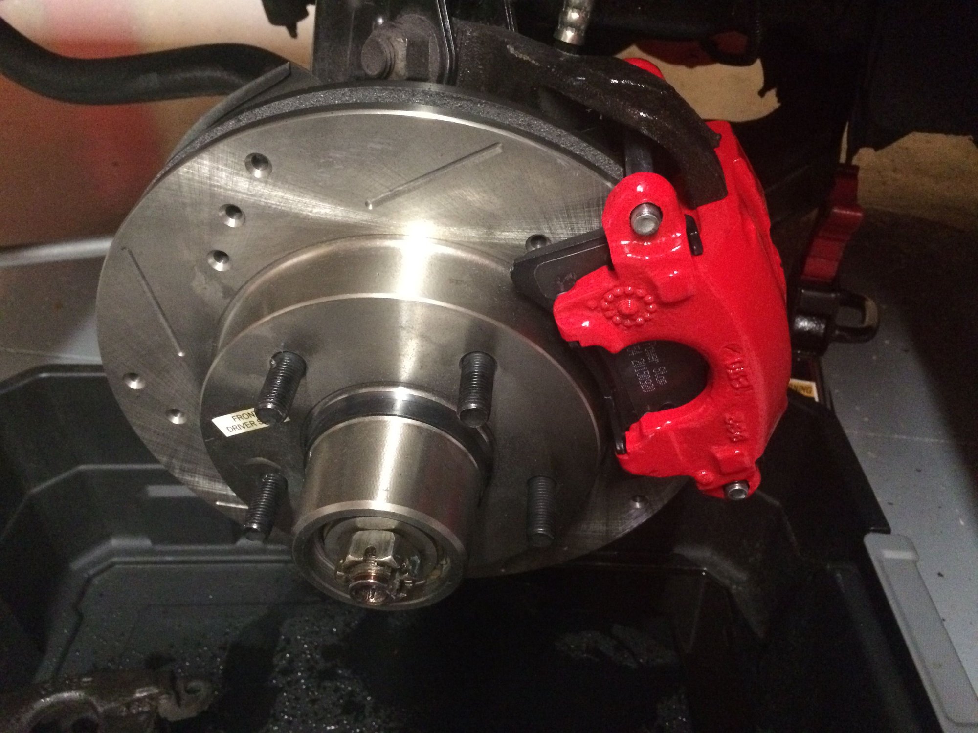

Summit part numbers where I got mine.
TMK-8871 SEAL $2.97 each
TMK-SET34 SET $10.97 2 $21.94
TMK-SET6 SET $8.97 2 $17.94
Nice rotors if you need them. Of course there are cheaper ones.
SUM-BR-62013L DRILLED AND SLOTTED ROTOR
SUM-BR-62013R DRILLED AND SLOTTED ROTOR
Get one of these and packing is easy.
