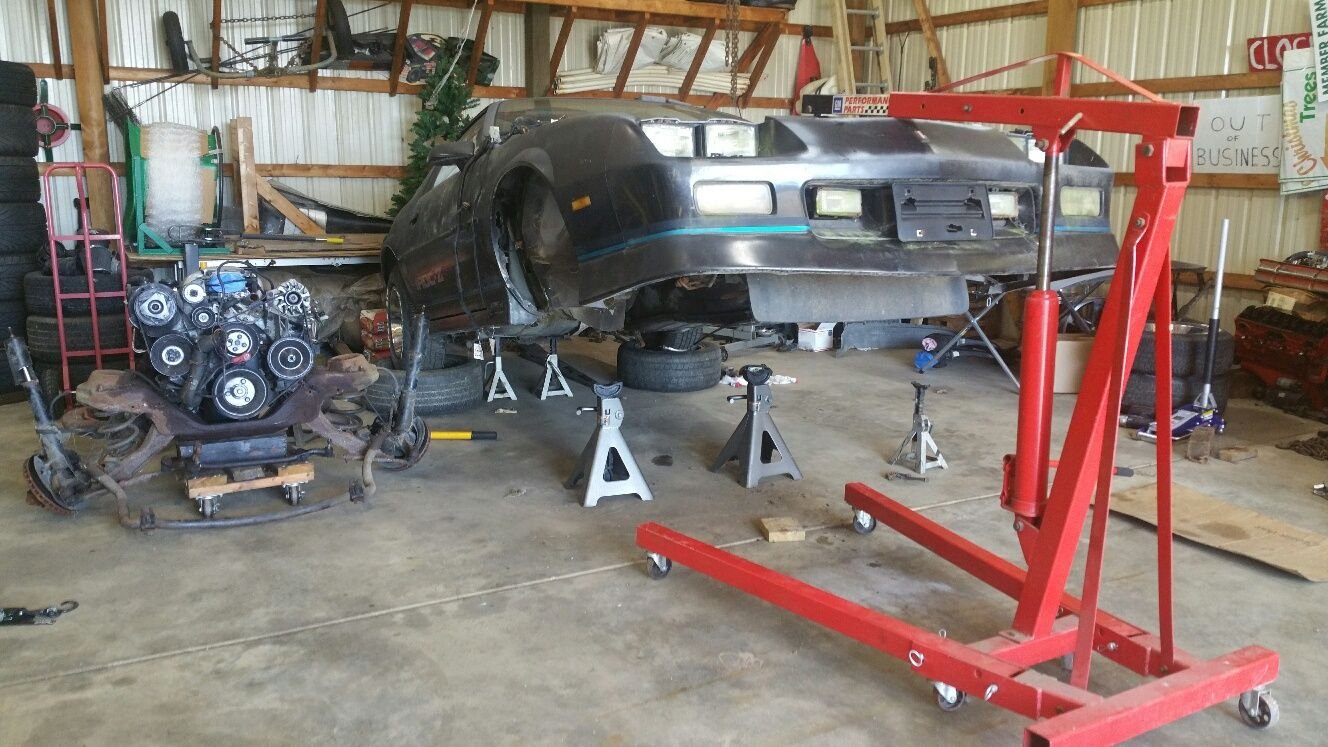

I have/and do drop the eng/trans together out the bottom by raising the body with an engine crane. Lift would be nice.
I leave all the suspension, exhaust connected and just roll everything out together...

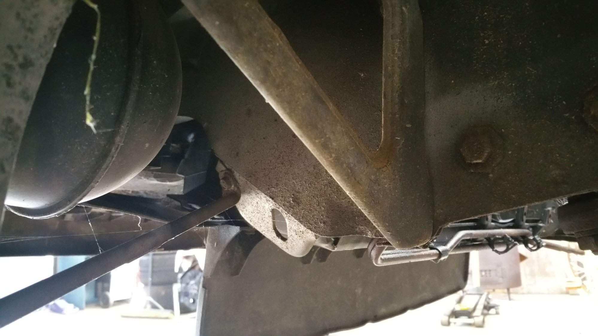

What attachment point(s) do you use to connect your hoist to the body while you are sliding the K-member and motor out from under the body?

Sorry for the late response...
If you zoom in on the top picture, I think you can see the hook from my chain in the vertical slot on the outside part of the frame on the passenger side. I think I just looped my chain under the frame and hooked it there. I may have threaded it thru the steering link bracket first, then under the frame to hook it. Here's the slot I'm talking about .. there's plenty of meat there in my opinion.
Here's a closeup of the drivers side. Again, zooming in on that picture, it looks like I looped around the frame in front of the steering box and then thru a brace on the outside of the frame, then hooked to slot in front part of the outside frame.
