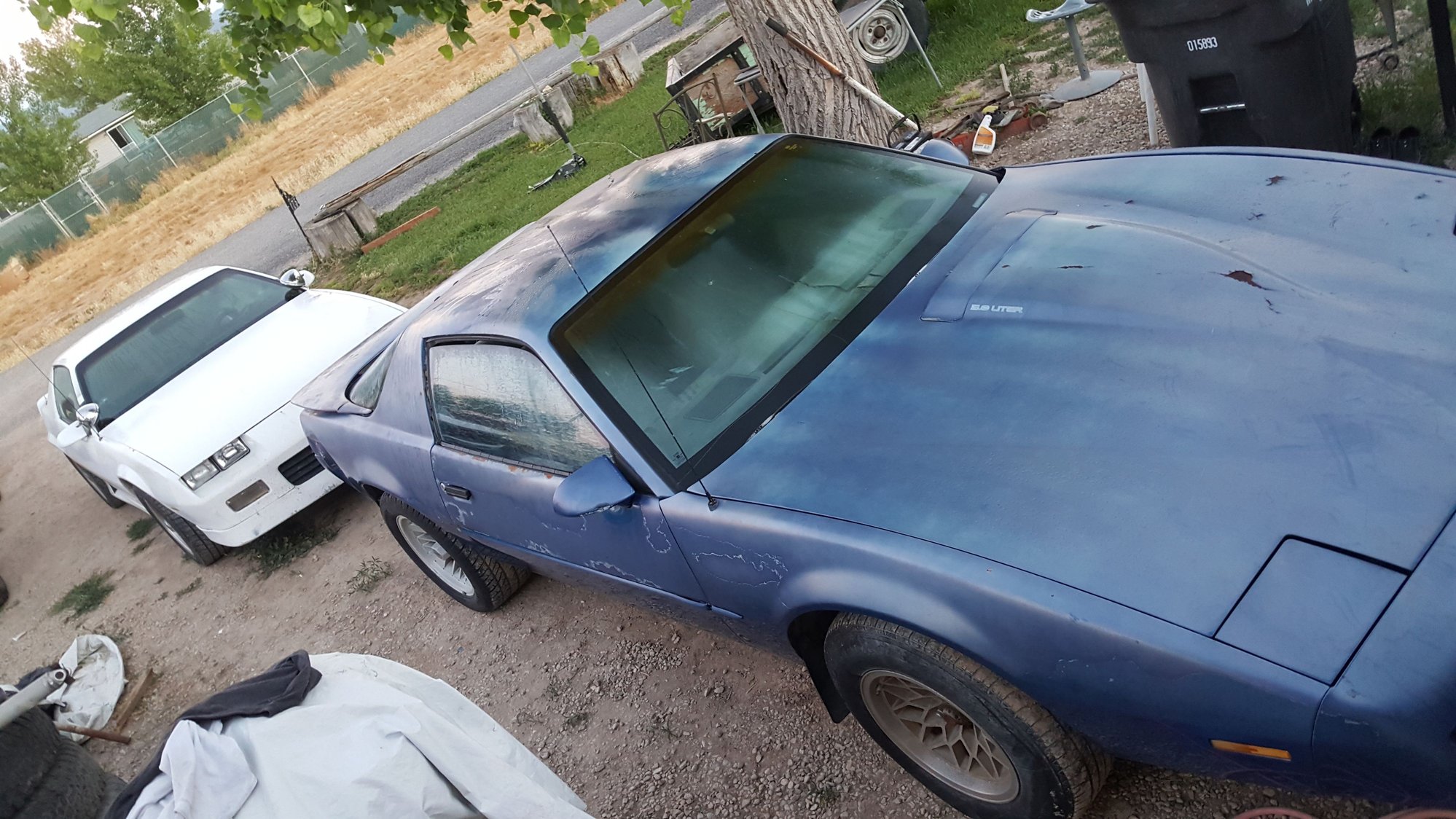

Trying to decide what bushings to put in each car. The b4c 1le that I own I am willing to install tubular control arms in so that's not an issue there. But do they make rubber bushing control arms vs poly? I was I was hoping to maintain the nice smooth ride quality of my b4c and keep road noise to a minimum. It's just a daily. As for my formula 1le. I'm definitely keeping the stock control arms. However I can't seem to find any part numbers for factory replacement rubber bushings? Any help? The formula 1le will be restored to factory spec.
