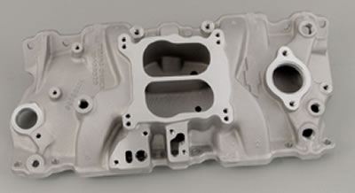

The first intake we'll look at is the edelbrock performer. It has more plenum volume then the stock intake so it can help reduce the pressure losses when an intake cycle occurs. The runners are similar to most stock intakes. The ones will look at are the pre-86 spread bore, 87+ spread bore, and the tbi.
A pre-86 intake is a good solution if your using an older style set of heads that doesnt have the angled center intake bolts. The performer is available in both non-egr and egr versions to suit your taste. Its similar to a stock Q-jet intake.
The later model intake will bolt directly to all non-vortec stock SBC cast iron heads made after '86 and is also available in both egr and non-egr versions
Both of these intakes also accept the stock brackets and some of the performers will accept all the sensors and fittings. However, the some of them only have two 1/2" NPT fittings and the stock waterneck prohibits using one of the fittings so the unused boss must be drilled and tapped for either 3/8" NPT for the CTS or 1/2" for the heater if your keeping the stock slanted waterneck.
The tbi performer intake should be a direct bolt on. It has a larger plenum so it should be a step up from the stock one so its not a bad choice as far as thats concerned. Its not the best flowing thing out there, however, so keep in mind that with a healthy 350+ ci motor itll be a restriction. Also, its only setup for the standard sized tbis so itll have to be bored out for a larger tbi
