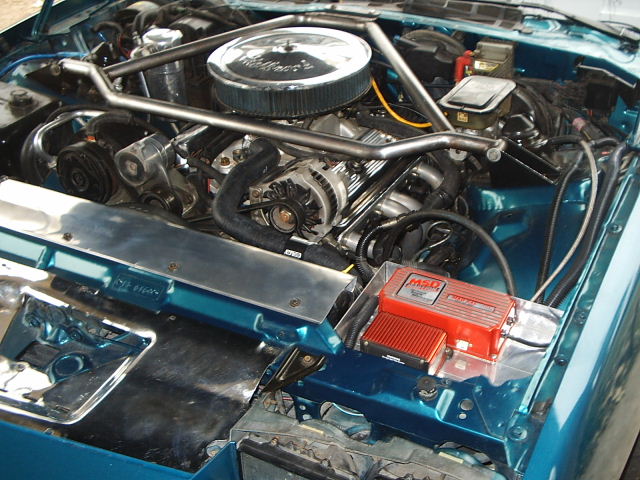

Finally got around to doing my vortec head swap, it took a while but it was well worth the wait. I started off with a brand new set of 062 casting vortec heads and topped it off with a marine vortec TBI intake without EGR. Heads were milled .030 but other than that they are completely stock. This is what my car needed, these heads really do wake up the 305 it pulls hard on the top end. As expected it is in need of a good tune, but it has a very noticeably louder idle
Attached Thumbnails Vortec 305 up and running!!-c-documents-settings-michael

Very cool man, do you plan on spraying it more?

Sharp looking engine bay

Sounds like it worked out well.
The Vortec's made a good increase in power over (if I read your sig correctly) the stock TPI heads?
And is that a 14 x 2" breather that you have on there?

Good to hear man. It is amazing how hard a little 305 can pull with vortec heads and an LT1 cam. Keep us posted on the tune.

I definatly concur. Wish mine was that clean

Where did you get that intake manifold?

The intake I found on Ebay some guy was selling them for 140$ plus shipping brand new. They have no EGR and already come with the 2" bore. http://cgi.ebay.com/ebaymotors/ws/eB...tem=4511959355
He has about 30 intakes left
I always try to keep my engine bay as clean as the outside

That intake is really great. I didn't know that they made that. Is that intake still produced at all? I bet it performs similar to their other performer intakes (including the performer TBI) but the application to vortec heads is what make it a nice option.

I was suprised when I saw it too and for 160$ shipped it beats the 330$ GM intake. I guess becuase its for marine applications it has not been seen around here, but its still made by edelbrock.
DM91RS Its a 14x3in OE and I did have 305 tpi heads on there before that I had ported my self
Im looking for at least mid-12s on the spray with this new setup, with tunning, bigger injectors, and a 3000 Edge stall cause this slp stall I have now is a little sloppy on nitrous
