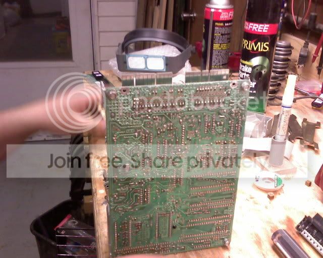

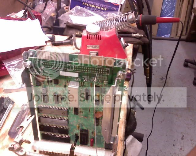

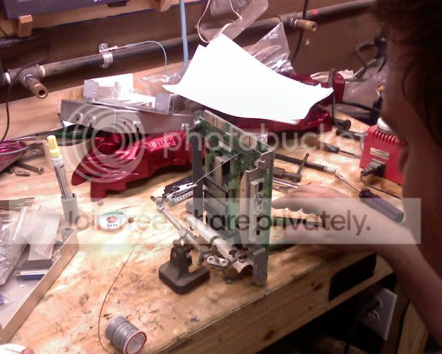

Here's some pics from this mornings HAM board install and EBL Flash install:
Also downloaded the appropo software and the EBL Flash-lotsa possibilities. Spent the last 4 hrs reading material! Gonna try and start tomorrow.
