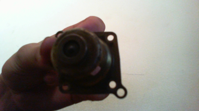

I dont have a lot of experience and I'm trying my best not to mess up any parts so sorry if this is an obvious question.
I am trying to make my Fuel pressure regulator adjustable. Do I need to drill out the black piece on the bottom? I've read the how-to tech write up but I just want to make sure because the little 'cup' came out with the spring so it wasnt pressed in.

What your trying to do is free the adjusting screw head from the regulator body.
Use a drill size that just fits into the hole.

ok, makes sense, Thank you

This should help. http://gmtips.com/3rd-degree/dox/tips/afpr/afpr.htm
