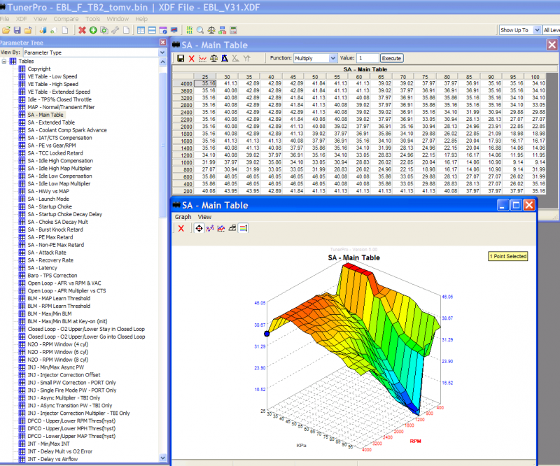

With the aluminium cylinder-heads, the LT1 SA table should be a good starting point
https://www.thirdgen.org/forums/atta...93-trans-am-sa
I used the Dart Eagle 220 cylinder-heads flow numbers from desktop dyno 5, as they are close to your description, this is the estimated ideal WOT SA that comes up, they go in the 90 and 100 kpa cells.
1000/24.8
1200/25.6
1400/26.5
1600/27
2000/28.4
2200/29
2400/30.4
2800/32
3200/32.5
3600/33.6
4000/34.7
4400/36
4800/36.7
5200/37.2
5600/37.5
Estimated required fuel (90 and 100 kpa cells)
rpm-fwhp-required fuel #/hr. To fill in the missing #/hr, can multiply fwhp by 0.532.
1000-58-30.9
1100-68
1200-78
1300-88
1400-93
1500-107-56.9
1600-118
1700-129
1800-140
1900-151
2000-162-86.2
2200-186
2400-209
2500-220-117
2600-228
2800-243
3000-258-137.2
3200-274
3400-290
3500-298-158.5
3600-305
4000-333-177.1
4400-357
4500-362-192.5
4800-371
5000-373-198.4
5200-365
5500-353-187.7
5600-243
6000-300-160
I would set fuel pressure to handle around 400 fwhp, 18psi with the 90 #/hr injectors.
For the 90 and 100 kpa VE cells, assume the number 85 of the VE cell to be the ideal max fuel your injectors can deliver (211.8 #/hr), according to the excel file.
Play with the psi numbers of the excel file to find how much fuel it takes to fuel the estimated fwhp. Exemple with 305 fwhp at 3600 rpm. in this case (10.45 psi) 161.4 #/hr.
I make it this simple 85/211.8*161.4=64.8 and put the number 64.8 in the 90 and 100 kpa cell @3600 rpm.
VE learns, takes a steady and linear throttle, best is to do it at idle and cruising. After doing some VE learns, smoothing some peeks and holes in the VE table is easy with the grafic.
I hope this will bring you a step further.

Re: Backfire Through TBI on Acceleration

Strange things - just re-opened a BIN I created and noticed all the values changed. Not just some minor stuff but for example SA's of 0 at 0 RPMs changed from 0 to 64. Other values showing numeric/alpha characters. Must have have hit a wrong button somewhere. Deleted files including programs and re-starting this mess.
Also noted on WUD display with just the ignition on the O2 sensor (heated) sporadically jumps from about 125 mv to 500 mv. That normal?
Ok those are hex values - still starting over since things may be jumbled. Having an issue - in TunerPro I called up the XDF file "EBL_V31.XDF" then called up BIN file "EBL_F_TB2.BIN", clicked on Main SA Table and I keep getting the hex file which I can't edit. What am I doing wrong here? - followed EBL intro - going back to try again but feel free to chime in if you know what I'm doing wrong.
TunerPro set to display hex values - not sure how that happened. Changed it back to calculated values in preferences - back on my tuning adventure...

Why do two files get opened in TunerPro - the BIN and XDF? I'm editing the BIN - right? What purpose does the XDF file serve?
In EBL utility, which MAP sensor bar do I choose (1,2, or 3)? Also noted there are tables only for 2 and 3 bar BST vs Boost values. Where do the calculated values get placed?
EBL tuning write up does not address these. Thanks.

Starting over with BIN file.
Some basic questions.
The BIN file is the one you are editing, this is the calibration. And is the one that gets Flashed into the EBL ECM.
The XDF file is a definition file. It has the data conversion equations, data locations, table layouts, and so on so that Tuner Pro can format and display the calibration data in a user friendly format.
As for the EBL Utility, there is a help screen: ALT+H, H
The calculated values get placed into the table that is listed at the top of the data.

What I did - First created LT1 SA tables per above then overwrote the 90 to 100 kpa values per Dart Eagle flow numbers and flashed it then read it. Something made changes to the values - first all the 0 values at 0 rpm were changed to the 200 rpm values, other lower rpm values were knocked up between 200 and 400%, mid range (1to2k) were factored down by 50-70%, and the higher rpm ranges in the wot area were factored up 15-25%. This normal?
Did not try starting it yet.
Note - I will be unable to respond to any questions until Tuesday next week. Change in plans had a little extra time to mess with this
Update - Changed SA tables values to LT1's verbatim leaving out dart eagle wot values. EBL accepting the values better - whatever was smoothing things before just didn't look right and until I get a better feel for what I'm doing I'm just not comfortable with those adjustments. Started fine no test drive yet (no time).
Believe I finally have fittings I need to test the FP stability. Will post.
Trying to understand Thomas VE table directions - after some research I'm still confused on how to calculate/populate the balance of the VE tables.
Sounds like something is not set up correctly in your tunerpro, double check the XDF file settings. IF you could post a print screen of what is happening with your SA table, that would maybe help identify the issue.
When working on the calibration, EBL has nothing to do with it as it is done in tunerpro, when the custom bin (created in tunerpro) is ready you flash it in the EBL and EBL will load it on to the desired bank.
My VE table directions is my own method, what VE cell exactly do you want to calculate?

Help - I'm must be doing something wrong. Below are the in and out BIN tables. First is the "in", second is what it turns into after I read it. Ignore the asteric on the BIN name it was saved.
Also I can't run EBL without shutting down my antivirus which keeps disabling the programs. This normal? I'm taking the dumb $hit hits without pain so don't hold back. Thanks.

In the first pick the LT1 SA table is good, at this point you should only have to save the changes to the bin. The values are then not supposed to change alone.
I can see what happened to it in the second pick, I have no idea what could cause that.

Strange, huh? If anyone else has a clue please advise. Looking at the table and wondering why I even need those lower rpm values.
May go back to original EBL_TB_2 BIN and just overlay values at the corresponding KPA/RPM points in the table without expanding the table. Maybe that's what hosed it (the expansion).
EDIT - OK, just changed the tables per above (plus BPC and AE adjustments). No xdf messing. Without starting the car (too loud for a Sunday AM) everything seems to have taken properly without something changing the values. This based on a read of tables after flashing. I must have hosed something in the xdf b4. Will post running and test drive results - may do today. Keeping my hopes up...
