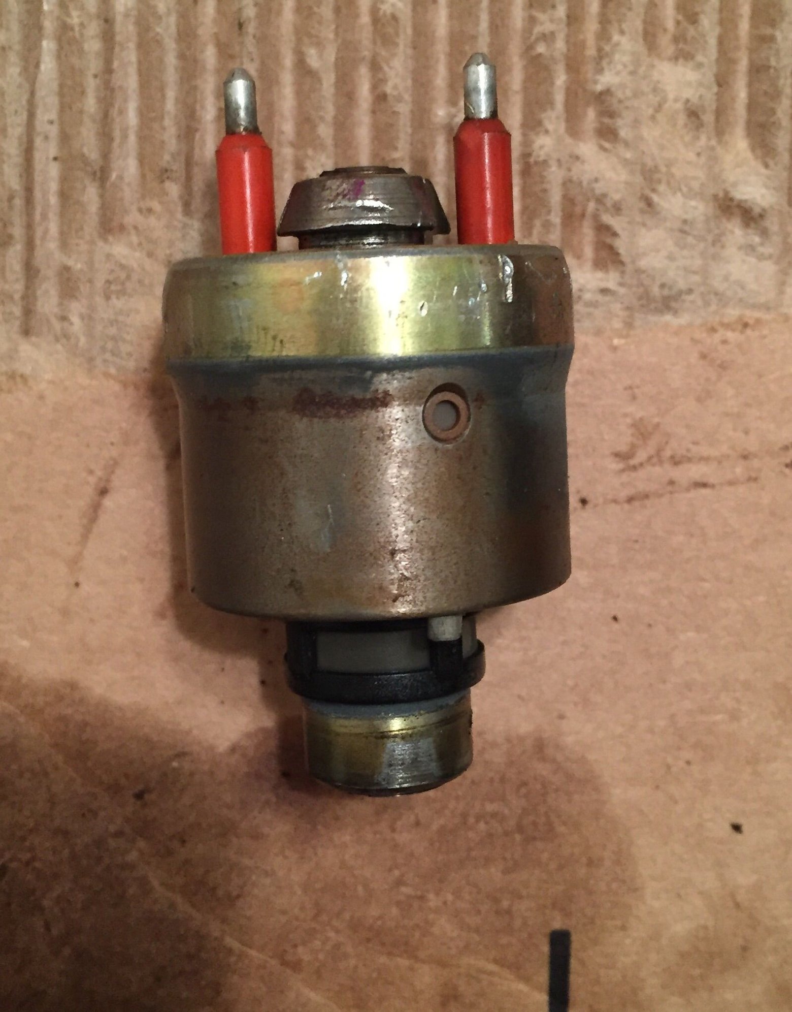

Got them out... Just the 5 torx on top and then I used a good pair of channel locks and slowly wiggled them out.

Ouch! that gouge on the injector might cause a leak check it carefully when you start it up.
