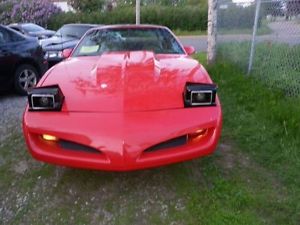

i have a pic of the engine bay... its looks pretty unmolested but maybe a more experienced eye may see something i do not.

Photo does not reveal what happened to the majority of harness connectors, but the main harness bundle appears to be there. ESC module is still mounted. MAP sensor bracket is still there, but the sensor is missing. There are two funky relays that have been sliced into the harness. This will have to be reversed and patched up. Is ECM still where its supposed to be???
One are of concern is copper looking fuel line! In EFI system there are several lines that run between engine bay and fuel tank - supply (3/8"), return (5/16") and vapor return (3/16") from CCP mounted driver side radiator support - purge solenoid is ECM controlled. Fuel lines run on the driver frame rail and have a flex section between engine and frame rail. These are missing. PS pump is also missing.
I would look for a complete engine - trany combo and take every last bit including harness which is a royal PITA to remove. Some slicing will be involved. I have fixed ******* hill billy conversion of worst kind in the past. This is one is not that bad, and it will take time!!!!!

thanks for the help... I already have donor car so to speak as I currently own a now wrecked 92 Pontiac firebird which was hit by a police car last year so I have the parts needed to put her back to originality.
with regards to the ecm Im not sure if its there or not because I never got a look inside the cab. If not I have all that in my own car. again thanks for the help its appreciated.
