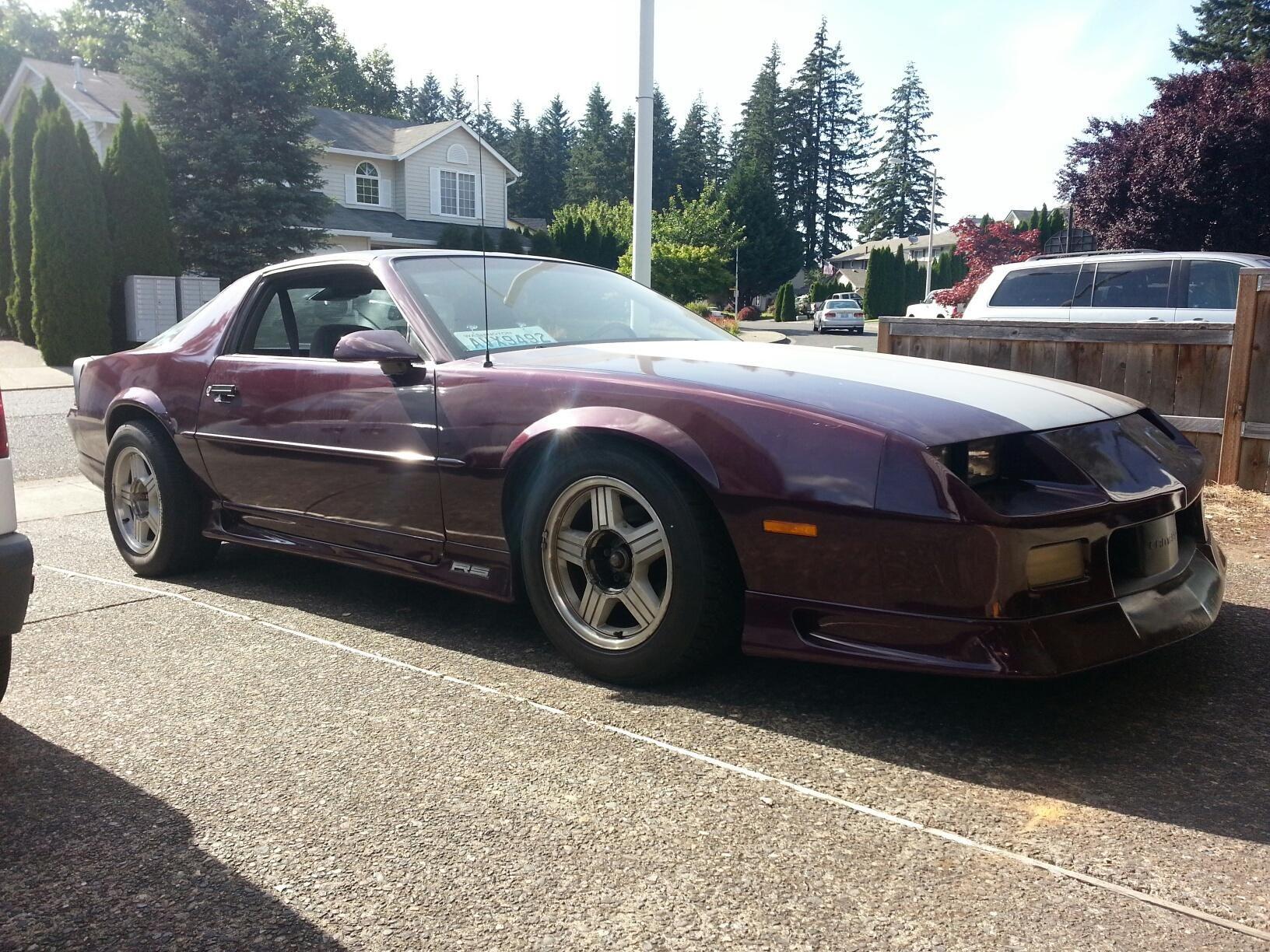

Your paint and body work is top notch. Might be too stressful for me. Mine is presentable, but not perfect.

Your car looks great.
Love the stance,color and the wheels.
