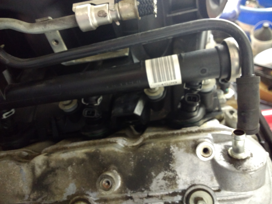

OK, so just for the halibut, I snapped you guyz acoupla pics of a LQ9 I bought the other day.
Whaddya think?
PCV valve in driver's side valve cover, and makeup air in the pass side one. The makeup air in this application, since it has to be downstream of the MAF, comes off of the TB, such that the air is cleaned and filtered by the main air cleaner; whereas in a TBI car, with no MAF, the makeup air comes through the little filter in the air cleaner.
José, plumb your car somewhat like this. One PCV valve, one clean filtered makeup air port.
