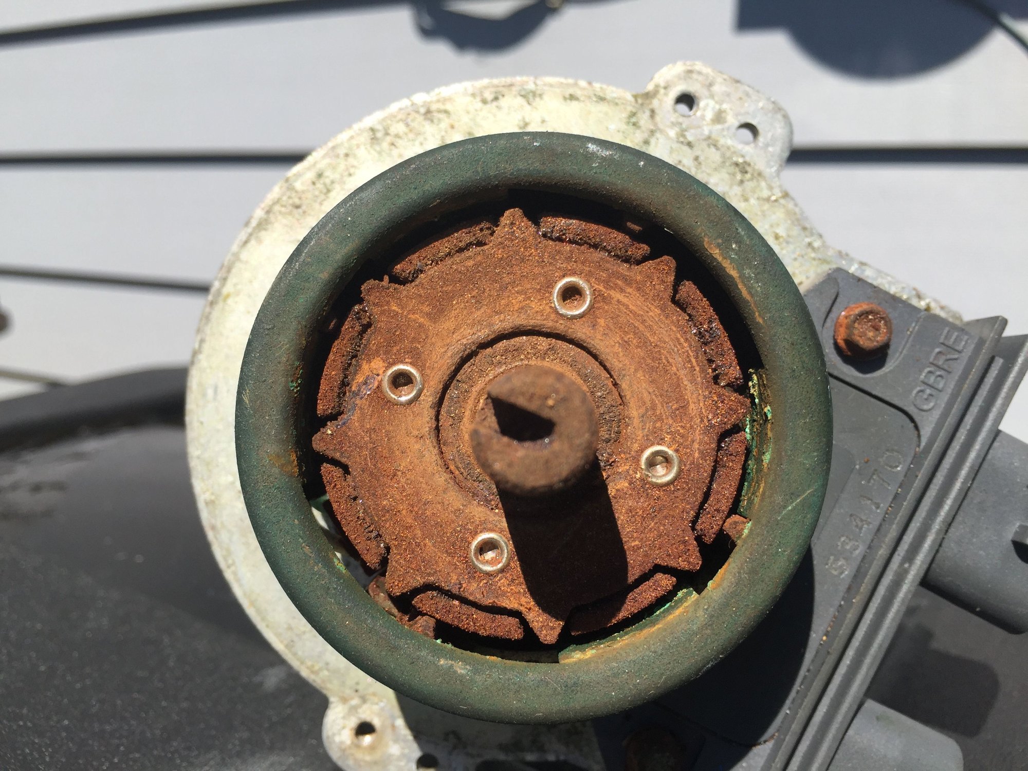

The rust issue can't be overstated. I had a bunch of issues with my L98, until I realized the rust was causing some odd triggering. Replacing the distributor two years ago resolved the problem.

Surprisingly, the car was still running with this mess...but badly.
