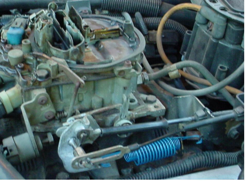

i tried the carb cleaner and it didn't work. can someone show me where to lower my idle?

here

First of all make sure the throttle lever has full movement. Put the gas pedal to the floor once ( car off) and then check the throttle position. Can the throttle lever still move forward ( towards the front) ? If so then the return spring is not strong enough to pull the throttle lever back to idle. At that point turning the idle screw isn't going to help you at all.
This is the idle screw
Attached Thumbnails i put in a new throttle return spring and now...-spring.jpg
