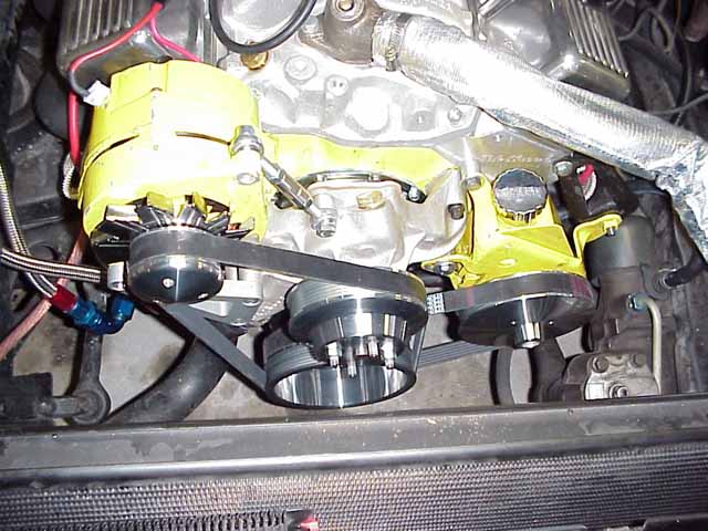

This is not crazy, '1991tealRSt-topGuy' cause I just did it!!!
Summit #
MCH-624................72.39
MCH-6380..............191.95
I'll post a pic tonight, I just bought the two serp. belts for it. I still need to run out there tonight, and install them.

Summit #
Ron
Here's the picture...
I'm using the stock power steering bracket, but I do have a March alt. bracket. I probably will get there PS bracket in the future, but for now It works.
Ron
Ron
