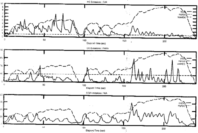

I've got a Turbo TA and am fighting the same problem; high HC, normal CO.
I am beginning to suspect false readings from the fuel tank as well. I do know that the last owner dropped the tank to install an upgraded fuel pump, however I do not smell gas, and I do hear the pressure hiss out when I open the gas cap.
The car's original cat had been gutted, which I did not know. I went for a test, and failed with 3.6 HC, 14.2 CO, and 305.5 CO2. (This is GPM on an Illinois IM240.) I swapped on a known good cat from a friend's car, and did the other usual tune-up items, and failed again. This time with 1.7 HC, 6.4 CO, and 399.4 CO2.
FJK -- Was your tank still pressurizing with the leak? I can hear mine hiss as I remove the gas cap. And whereabouts in IL are you located? I'm in the NW burbs and am thinking that your friend with the 5gas analyzer could be a big help.

In the beginning of the test, 2 of the HC spikes are worse than with the gutted converter (near 7)! Once the veh speed reaches 45-50+, then the HC hugs the limit line (although it barely ever goes under.) The HC trace does not seem to follow the CO trace. Actually, at a few of the worst HC spikes, CO is near zero.
I can email pics of the traces. I'm thinking maybe the cat wasn't fully lighting off at first, and this coupled with a small fuel leak, causing say, .5 constant false HC, is the culprit. What are your thoughts?

Alxtta 1: Either post or e-mail (private message) the traces after your last test that had the better cat.

FJK - Here's the latest trace. Any advice appreciated.
I was talking to a guy in CA and he found one issue. Normally, I run my car with a breather on the driver's side valve cover. For the testing, I'd been replacing it with the stock oil cap. By doing this, I had basically blocked any vent for the PCV. He thought this might be a problem and suggested I run with the breather.

2 things:
what do you mean, the tank was pressurized?? if anything there would be a slight vacum.
secondly, low CO and high HC would indicate a lean miss. The car misfires because the mixture is lean, resulting in unburned hydrocarbons, High HC

ALX:
In looking at your traces, it seems to me that you have some fundamental engine problems & not a fuel tank leaking problem. You said you did a basic tune-up, but did that cover all aspects of the ignition system, plugs, cap, rotor, ignition wires? Although your CO passes, it is still not that clean. Here is what I would be looking at:
For HC's:
Ignition system tune up as stated above.
Air pump system;pump working, divertor valve working, no leaks on plumbing.
Ignition Timing Set Correctly
Fuel Pressure Regulator vaccum line correctly connected to intake maniflod.
Turbo boost leaks
For CO's:
Replace O2 sensor if more than 50K miles (might affect HC as well)
Both HC & CO
New CAT

Hmmm, thanks. The Turbo TA has a DIS (distributor-less) ignition system. There is no cap or rotor, there is a coilpack. I need to check that. I did replace the plugs, and the wires seem to be good, although I still need to check their resistance.
There is also no AIR system, as far as I know. There is no pipe for it on the cat. Timing is set within the chip. The fuel pressure looks fine (I have a gauge for it on the A-pillar.)
The 02 sensor is a brand new, stock replacement.
I really hate to just start replacing other parts, ***** nilly. I need to find a mechanic close by that I can trust to truly diagnose the problem.
