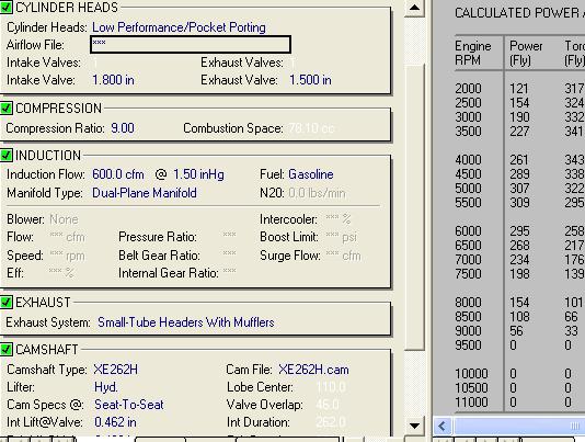

Can someone Dyno this for me.
305 bored over 30 dished pistons ported and polishe 080 heads stock 1.84 intake and stock 1.50 exhaust valves 1.6 rollertip rockers 224/224 @ 0.50 duration .465 int lift .465 exh lift lsa 114
holley street dominator intake with a 600 holley carb. stock converter and rear gears hooked up to a 700r4 tranny with shift kit and vette servo. No emissions flowtech headers y-pipe and hollowed out cat. Let me know if you need anything else

Geez, and I was told that I didn't do anything for these boards, least I didn't give a smartazz reply.
Here ya go, buddy, not sure if I entered everything in right, but gives you an idea, I just picked a saved cam file for use.
