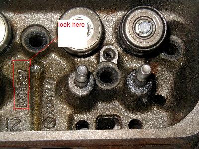

Old Dec 23, 2002 | 05:21 AM
Riley's35089rs+'s Avatar
Joined: Nov 2001
Posts: 2,743
From: heartland
Car: 89rs (previous 2.8)
Engine: 406
Transmission: 700r4 (for now)
I think you have your # confused or you are looking in the wrong place.......look under the valve cover you will see the # here.....

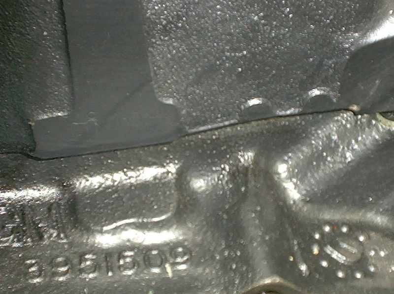

Old Dec 23, 2002 | 06:11 AM
RB83L69's Avatar
Posts: 18,457
Likes: 16
From: Loveland, OH, US
Car: 4
Engine: 6
Transmission: 5
624 heads are junk, among the worst ever. They are resopnsible for such engineering marvels as 170 HP 350s and 180 HP 400s.
Here's some double-hump heads with bolt holes.... casting # 3927186. You might want to check the block casting while you're at it... these parts didn't come from the factory as the same motor.
Old Dec 23, 2002 | 06:12 AM
RB83L69's Avatar
Posts: 18,457
Likes: 16
Car: 4
Engine: 6
Transmission: 5
Here's the other end of one.
Old Mar 8, 2003 | 11:07 PM
chymos's Avatar
Posts: 177
From: Augusta GA
Ahhh, I see. Nope, don't think I have the good ones.....but at least they'll get the car on the road
Old Mar 8, 2003 | 11:11 PM
RB83L69's Avatar
Posts: 18,457
Likes: 16
Car: 4
Engine: 6
Transmission: 5
Well that's OK, crappy heads are a whole lot more common than good ones, and I've had an embarrassingly long time to pick up good ones without spending much $$$$; get it running, but don't expect too much out of it, and don't sink any money into those heads. Save up and get something decent.

I am so upset after reading this. I cracked my 882 heads in my SBC 350 and I am about to pay a mechanic close to 1400 dollars to put new heads and a 120$ elgin cam in (I bought the cam). I looked up the casting number when I found out what it was (took a picture at his shop) and they are the 463624. They are from a machine shop and have just been refurbished I guess, is there any hope or did I make a really bad decision. I know this was discussed on here a lot but I don't know hardly anything about this, I can't even tell from the pics if these are the "good" ones, although I assume they aren't. I paid 400 for the heads from him, the rest was the labor. feeling uncomfortable about now.
http://postimg.org/image/j163frdph/
http://s2.postimg.org/jt8reyhwp/heads_3.jpg
http://s2.postimg.org/6qi6ssy09/heads_4.jpg
http://s2.postimg.org/uhcidsrvt/valves.jpg
