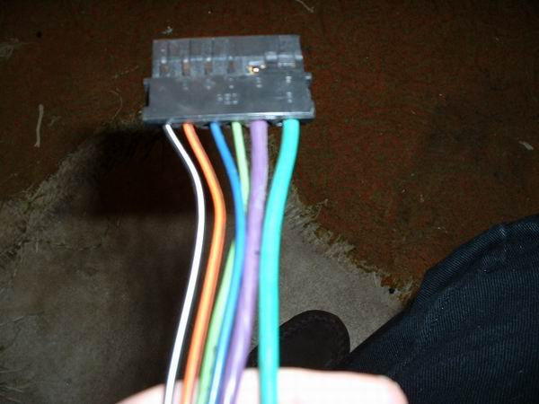

hehe funny you mention this...
I had to get the plug for my IROC not too long ago. I went to Pep Boys and got a male 2 pin connector and a pack of male pins (I think thats what it is. The wires come from the Netural saftey switch from under the center console.. I beleive they are the dark green and blue wires that goto it. (it is the 2 middle ones)
I ran some speaker wire from them 2 wires (with solidering the connections and heat shirinking them) down do the side of the tranny. Put the pins on it, then assemebled the connector. Pluged it into the tranny and whoo hoo! I have reverse lights.

Ok I lied.. Its a light green wire.. lol Heres a pic of it.
Kat
Attached Thumbnails What is this plug on the transmission for?-nssconnector.jpg
