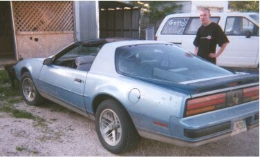

Any help in the process of rebuilding my old Formula will be greatly appreciated.
The car has been sitting for quite some time after hitting a deer. I know it still runs, it gets started approxamately every 6 months. It's all the way back in Oklahoma while I sit here in the Detroit area until early May when I will go get the car. Any tips for for prepping the engine that has sat for a few years? Anything I should look for? Things that are aleardy planned for are fluid changes, spark plugs and wire change and a new distributor.
