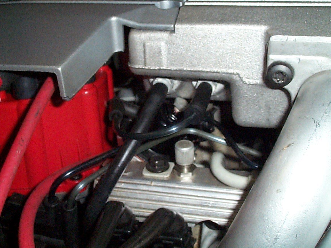

FB is correct - you've got spark, and you are apparently cranking. With a TPI, if it's been twenty seconds since the ignition was on, as soon as you turn on the ignition, you should be able to hear the fuel pump run for about two seconds. This should build pressure in the injector rails. On the right rail near the rear of the intake plenum is a Schrader valve used to test fuel pressure. Remove the cap from the valve and slightly depress the center core stem (like a tire valve core). You should get a spray of fuel from the fitting.
If you have fuel pressure there, the pump can be assumed to be operating and the injectors are not firing. If there is no fuel pressure at the fitting, or if you don't hear the pump run, you'll need to check the fuse to the fuel pump. The fuse is located near the battery on many ThirdGens.
