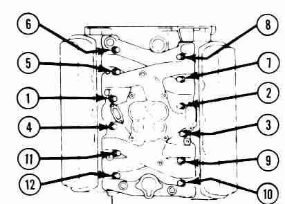

Can someone give me the bolt sequence and torque specs for an edelbrock aluminum intake manifold... (7516) edelbrock's phone lines are closed, and i havne't got an email back, and can't find the sheet that says it
i found the general intake manifold install guide, but not the speific one for my car...

did a quick "Google" search using keywords:
chevy intake sequence
the first link they found was to this
always start in the middle and move to the outside and youll be safe, it doesnt need to be specific....
