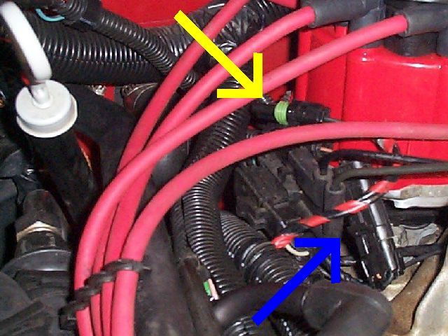

Save your cash, find the harness yourself, and install your own MAT/IAT sensor. You can get the sensor for about ten bucks (Wells SU109 - $9.99), and clear the stored codes. The MAT/IAT sensor is not that critical, so an aftermarket sensor should work for you with no problems.
Hopefully, the technicians that diagnosed your car understand that the MAT is located on the underside of the intake plenum, and is all but invisible unless the intake is removed. They may have missed that one.
This article may give you some hints about where to find the MAT/IAT sensor, the harness, the connectors, and what to do about it:

There is one connector right here (yellow arrow):
