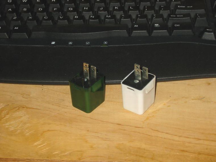

Anyway, here is a picture of the two relays that were in the courtesy box. I replaced the green one last year, but who knows, eh?
It is this small circuit board that sits right beside them which is making the buzzing noise.

The item that you are describing sounds like the audible alarm system that goes off when you have the door open with the key in the ignition, or open the door with headlights on.
