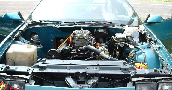

my question is, why are you using a Dominator style carb with a performer intake? way too much carb for that sort of setup. but anyway, here is an old photo of a dominator we used last year. with this setup, we needed a minimum 2" cowl with a 3"element air cleaner. sorry, no photos with this hood since we didn't use the dominator very long.
