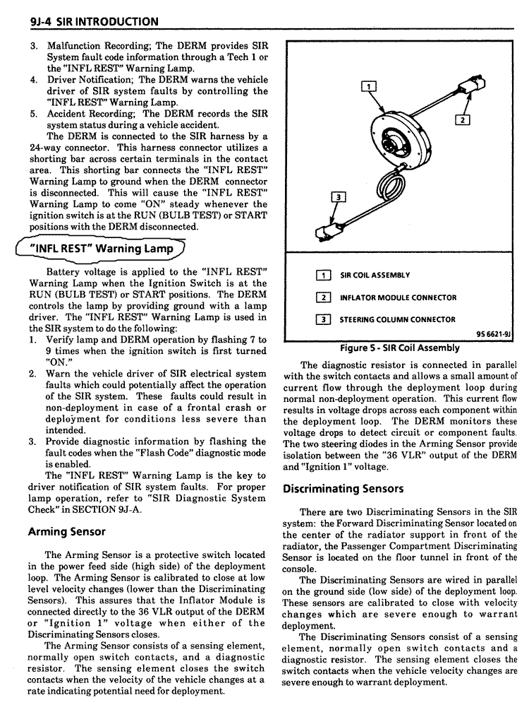

what is the infl reset light on a 92 rs 305 and why dosnt my 91 rs 305 have it

Hello DarkMage,
Welcome to the board. The picture below should answer your question about what the infl reset light is. As to your other question about why it is not on your 91 RS 305. I'm not 100% sure about this but I don't believe they started putting them in all the models until late production in 1991 or 1992.

Thats the light for your inflatable restraint. Or air bag. One of your cars probably has the driver airbag and the other one doesnt. Or else the light is just burnt out.

if you remove the air bag will it make that light stay on 24/7?
Old Jul 21, 2004 | 05:53 PM
dankhound's Avatar
Posts: 1,322
From: Bloomingdale,IL
Car: 91 RS
Engine: 305 Tbi (L03)
It should stay on when you remove the airbag.
