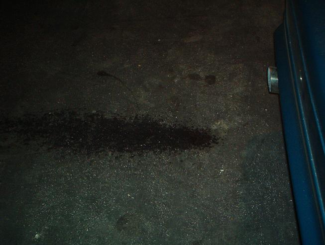

So here is what's going on
The car is idling roughly, and when i come to a complete stop, it feels like it's going to shut offf........
Over 3,500 rpms, it gets a slight shudder......
So what's going on? I replaced the driver's side spark plugs, fresh oil and filter.......
Any help appreciated.......
This CRAP is shooting out of the exahust.......

looks like it's getting way too much fuel

It smells insanely rich, however it's getting fuel pressure of 60 psi of fuel
Trust me, I know for a fact the catalytic converter is not clogged......

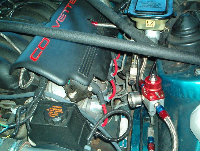

OK, so a little update, I got my MSD 8.5mm wires from Summit installed on the car today.......
Picture Below...
The car is running much, much better, however i can still sense a little hesitation while driving, so the problem is not entirely, fixed yet, but it drastically improved the problem..
Next on the agenda, the O2 sensors......
BTW, I still think it's ignition related. I just can't see how some plugs are fine but others are bad. Maybe they are overgapped?
Z28*****, mentioned that it might be a leaky fuel injector on the passenger side of the car, would this cause the situation that i'm describing??
