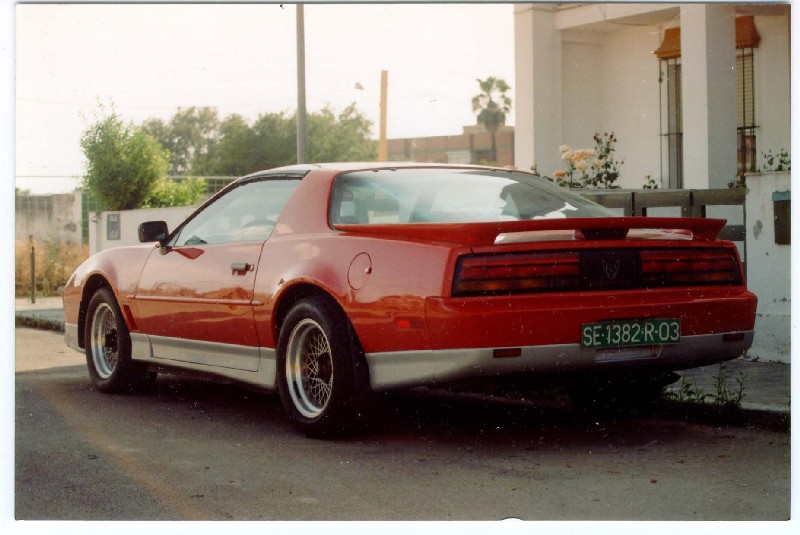

Hello.
First of all regards from Spain.
I want to pull out the motor of my 89 Trans Am. The problem I have is that I don't know the place where I put the chains, in the block? in the manifold? What tool are you using to do this, bolt or other tool?
It's possible to you post some photos of the correct place/tool?
I will appreciate a lot you help because here in europe we don't have information
Regards
Marcos

Nice car, by the way!
