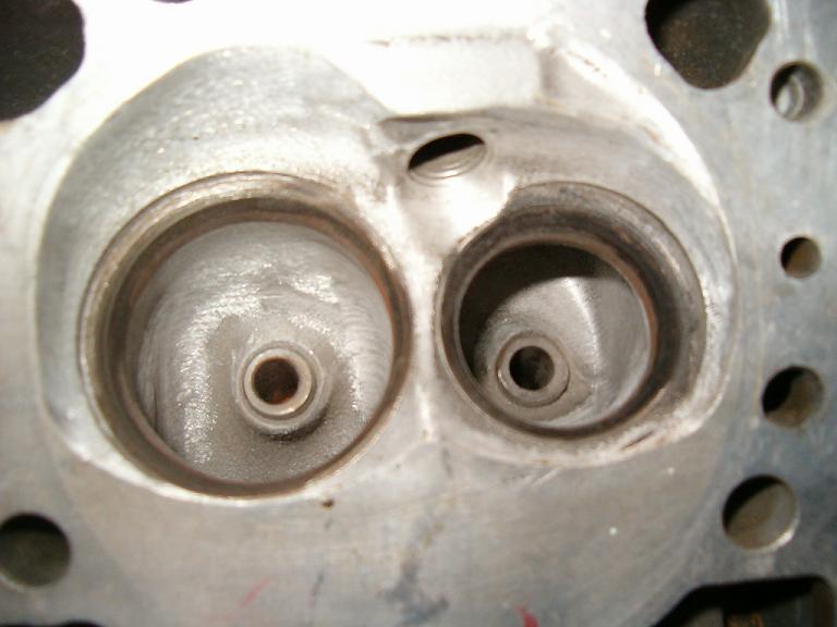

do these heads need any valve work
im putting these back together soon and need to know if theres anything special i need to know before i reassemble them. valves all look fine seats look ok too. at least from what i can tell.
Attached Thumbnails do these heads need any valve work-niagara-falls-trip-049.jpg

Can't really tell by just looking at them....
Put the valves back in, pour a little fluid of some sort, something real thin like acetone, in each chamber; see if it leaks into the ports.

Atleast lap the valves to make sure you have a good seal.

what do i do that with?

Valve lapping compound, no offense but google it.
