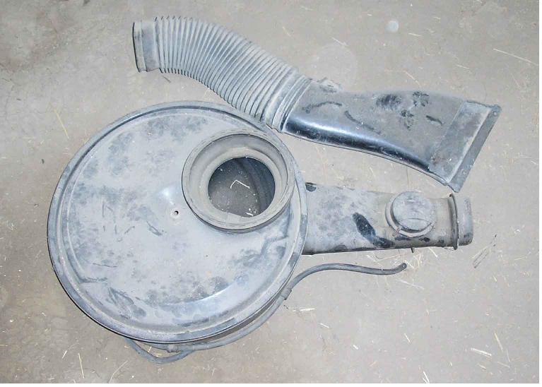

if your lid is like this, you will want the factory setup or switch to keep junk out

Although I'm not running an open element filter, I replaced my air cleaner lid with the same the in the above picture and my car went noticeably quicker than before. Having the cowl ducting in place didn't make my car go any faster above having just the lid with the hole in the side.
I then went to a K&N air cleaner lid to allow air to flow more directly down into the carb. My car lives outside in the weather and not even with rain have I personally had a problem with water getting into the wrong places.

It makes contact to the oil pressure sending unit, and several other sensors like the throttle kicker relay I think. When all the sensors reach a certian operating condition the flap opens. Disconecting the 1 power wire at the cowl will not hurt anything. I just taped mine off and hooked up an on / off switch. I had water in my aircleaner with the car parked and the flap open once after a heavy rain.
There is a air filter in there. Think of a lid that just covers the airfilter but is not big enough to cover the entire housing. Then attach a full size lid ontop of it. What you see in the hole is the smaller lid with a aircleaner underneath.

HMM, never seen a pic the carb version before, no air filter in the ducting? Of course I dont think the CFI I have collecting dust has one either.
