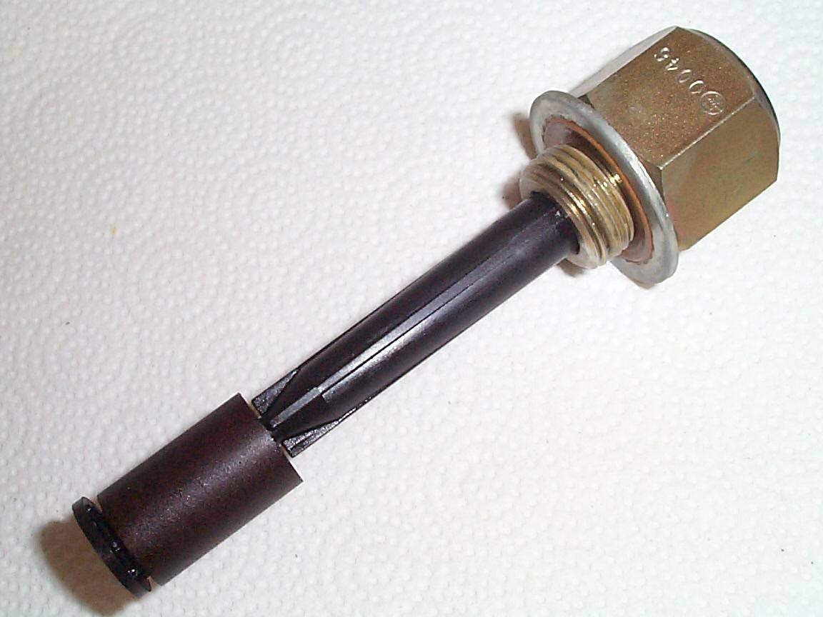

Does it look like this?

Pretty similar..that one looks like it's metal...and has less threads...but might just be a design difference though.

That particular oil level sensor is from an LT1, and is a 20mm x 1.5 thread. Your LO5 may be the same, or not.
My first choice would be to use a welding clamp (a.k.a. Vise Grip) and pull on the drain plug as you turn it counter-clockwise to help pick up the threads and remove the plug. Abandon the metric drain plug. Chase the threads with a ½-20 tap, then install a NEW oil drain plug, oversized if necessary. Keep plug torque below 8-12 Ft/Lb and it should work well.
