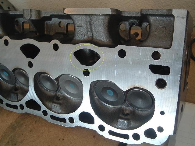

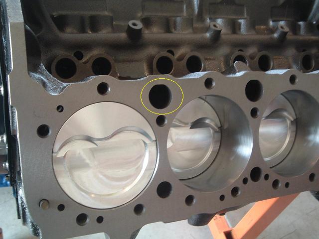

HELP!
I just got the gasket and everything looks good except something I just noticed:
There is a wedge shaped hole (presumably, for the water jacket) in the cylinder head, and I have a circle hole in the same spot on the engine block.
How is that supposed to work? I've attached pictures showing what I'm talking about...
HELP!
Thanks,
J

sbc head/block holes have been those shapes for years. nothing to worry about.
