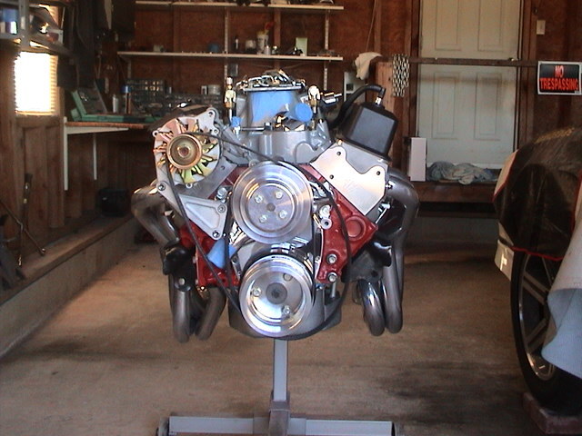

Ok...Im looking for a press on single groove power steeling pulley that will fit on my 92 Z28 pump. ....
Now what I used to have was the double groove pulley...but I dont need that anymore...Can I just get any single groove pulley for SBC? will it line up with my V belt setup?
what year 3rd gens came with single groove power steering pulley's...I can just get one of them.

I guess thats what I need...is a none A/C or smog pump pulley...hell I have no idea....but yeah if you have what Im looking for...how can I get it? I need it..
oh and I concidered the serpentine along time ago but decided against that...weighs more...and what I have seems just as easy to work on or change belts...so Im sticking with the V-belt setup....thanks anyways!
im putting the power steering pump on tonight and need the pulley..

I just bought a single grove pulley from my local napa.

and it fit and lined up right with the rest of the pulley system?
which did you get? one of those chrome ones that I see at like advance and AZ?

Mine fit just fine. I do have an aftermarket billet bracket tho. My pulley is a painted steel pulley from Napa. You could probly get an aluminum one from ebay for the same price you can buy a new pulley.
Any chevy powersteering pulley will work with any pump. The one on my car is for a 78 chevy truck without ac.
