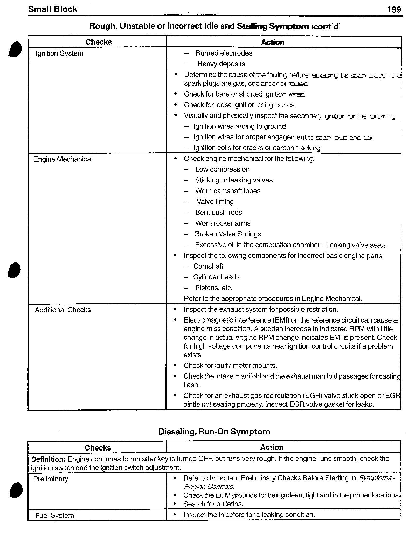

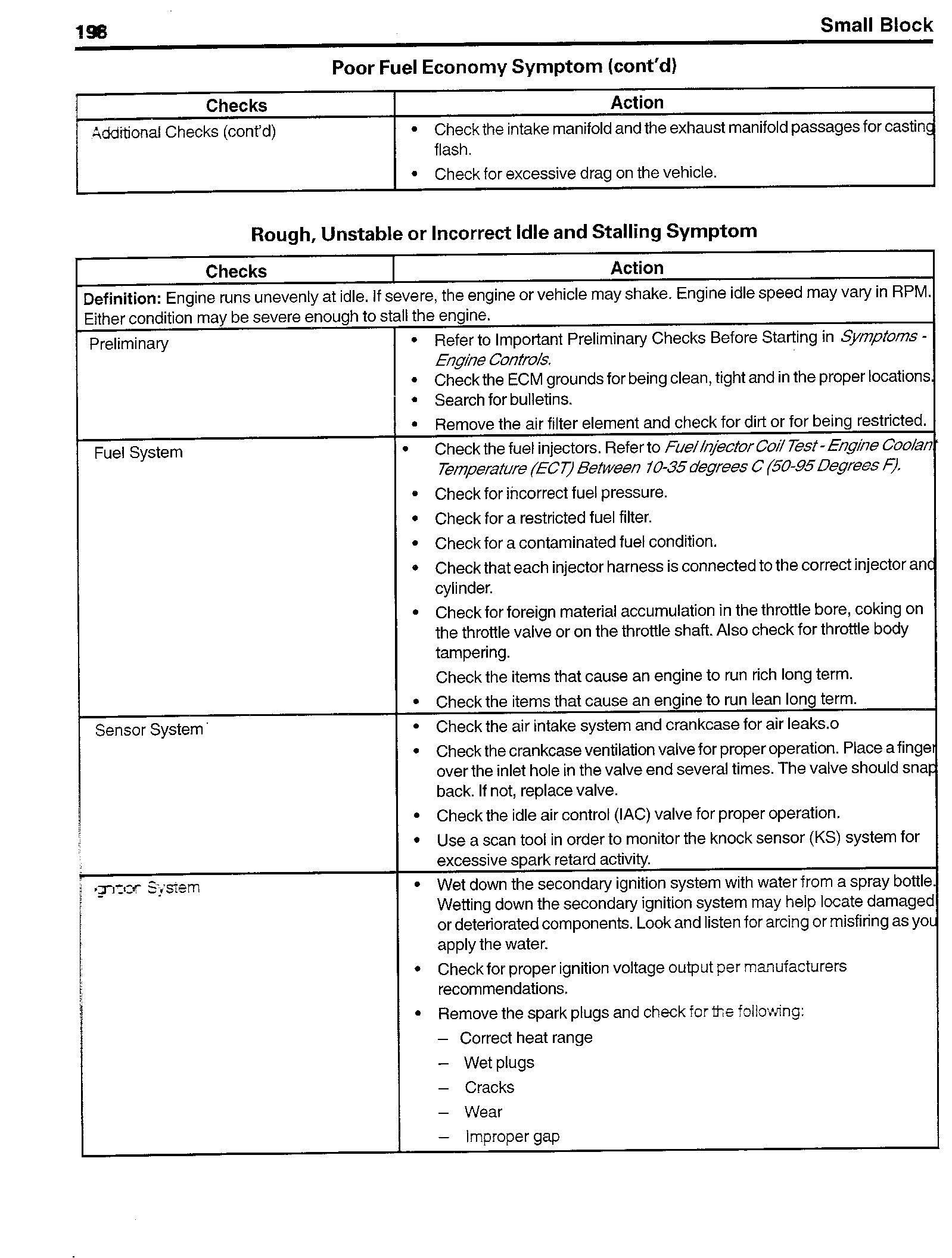

http://www.kemparts.com/TechTalk/tt13.asp this will give you an idea how to check the sensor.
Here is a couple enging control symptom charts out of a GM book I have Hope it helps.
Attached Thumbnails Still surging Checked everything... what else could it be???-cts1.gif   Still surging Checked everything... what else could it be???-cts2.gif
