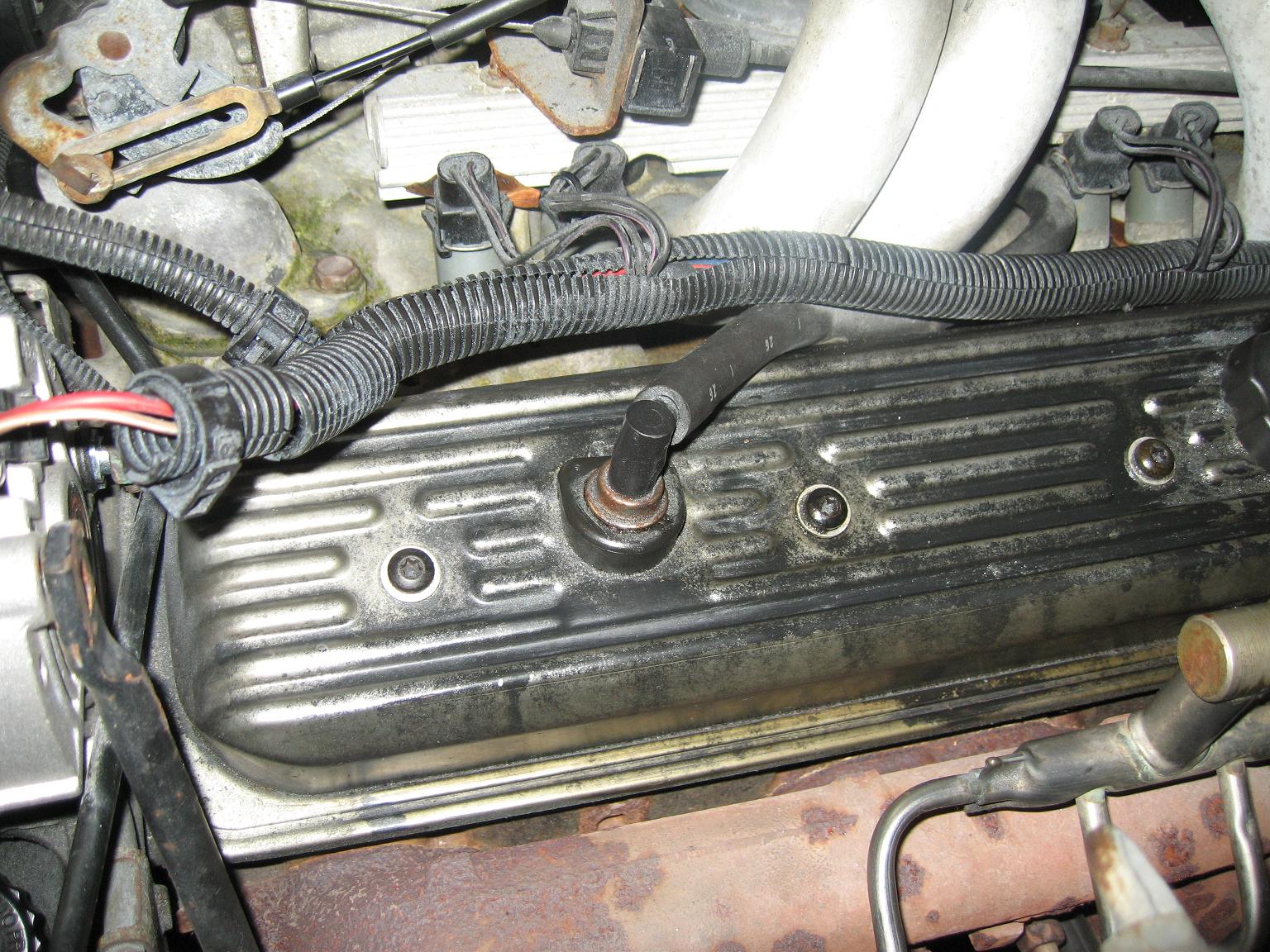

What sensor should be connected here?
Old Sep 21, 2007 | 11:46 AM
Speedball's Avatar
Joined: Nov 2006
Posts: 56
Car: 1989 Camaro Iroc-Z
This picture is taken of the front of the engine. As you can see, the driverside sensor is not connected to anything, and I have no loose wireing that I can connect to it. What is sensorwires is missing, and what should I do about it. and how do I do it..

I don't know TPI engines very well, but that looks like a coolant temp sensor. And so does the one right next to it. My guess would be one is for a gague and one is for a dummy light. You car may be equiped with one and not the other so one sensor is disconnected. OR you have a loose wire somewhere. Either way if your temp gague works, I wouldn't worry about it much.

well. my temp gauge doesnt work, and I have problems with the engine overheating and the fans not turning on. I just got a different sensor that I hooked up in my cow, and I had the engine running at 240 degrees and the fans didnt turn on. The engine used to boil when I parked it before I got the new sensor. (the new sensor and gauge is hooked up on the driverside at the lower part of the engine.. the old one was just cut off...)

Driver's side lower part of the engine? Can you show a picture? The fan switch should be on eht epass side cylinder head. I just replaced mine yesterday. So if you're fan is not kicking on when hot I'd look there. Does that fan work at all? Will it kick on when you turn on the a/c? In fact is your a/c cooling right? If you even have a/c. If the fan doesn't work at all then I would check the relay and the fan itself before the switch.

Thats weird.... I have an 89 GTA.. the coolant temp sensor is on the left side of that picture.. That could possibly be a fan switch..
Looks like the Intakes been off.. maybe it was misplaced? Check yur harness for cut wires.. you might be suprised with what you could find

Thats the air intake on the right, tensioner on the left, looking straight at the front of the intake manifold just below the throttle body.
Looks like coolant temp sensor to me too, and on mine, I'm pretty sure there's only one sensor there... may be wrong and I'll have to look when I get home.

Looks like somebody stuck two coolant temp sensors in there. My only other thought is that they relocated the secondary fan switch (normally on the passenger side head) to the intake manifold, and never hooked it up. It should be a single black wire that goes to it.

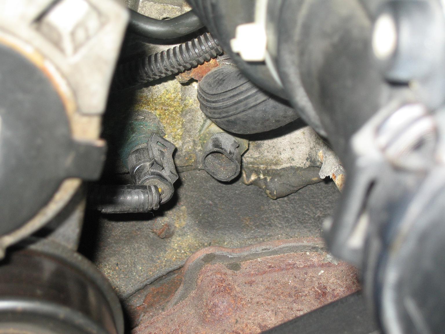

I think that all the wireing in the car is replaced. I have checked for cut or none connected wires, but I cant find any. I can check it out again later today. The sensor that I replaced is in the picture, but you can only see the "steelwire".
The two other sensors are there, but I can just pull them out with my fingers and I have no idea how to check if they work or not.
Picture of "the other sensors" is added...
Attached Thumbnails What sensor should be connected here?-img_2635.jpg   What sensor should be connected here?-img_2636.jpg

Is that wire for an aftermarket gauge? Looks like it would be. Hopefully you just bought this car.. cuz someone was doing a nice little hack job on it

Ive had the car for about a year now, and I was the one that bought the gauge since I didnt know any other way to get the temp without spending a bunch of money in a shop.
Nice little hack job? Im foreign:P what does that mean?

someone that worked on the car before you decided he didnt care much about how the car went back together as long as it drove. Basically sloppy *** mechanic. Not saying you are.. but the previous owner definetely did some fine work on it

As far as temperatures and fans go, you should have:
1 Sensor in the drivers side head with single wire (this looks to be the one you call "steelwire". This is the sensor for the stock temperature gauge.
1 Switch in the passenger side head. This switch controls the second fan (ECM controls the first)
1 Coolant temperature sensor on the front of the intake manifold. 2 wires go to it (yellow and black I believe).
I dont know what all that other crap you have is.

I think the dude that owned the car had lots of plans with it, but then he decided to sell it.. He got high compression heads and a mild cam and a flowmaster exaust for the engine, but as you say. everythings seems to be put together in a hurry.
The switch in the passenger side head should be there. The coolant temp sensor in front is there too. I just checked the wires and you were right about the colors. they are black and yellow.

Re: What sensor should be connected here?
You guys made my thread burst into flames..
I will run down and check the relay. Im not sure what to look for, but I will jiggle it a little and maybe even unplug it. Maybe I should just hook them up so that they run all the time? Its not like Im going to drive around too much when its snow and ice out anyways.

And I checked the relays by unplugging them and plugging them back, I also found out that the battery ground was kind of shady so I tighten it up. I dont know how much that matters.

Well. Im recharging the battery now, so I guess I just have to wait and see what happens...
I wish I had the knowlegde, tools and the room to fix my car.. Its interesting, but it sucks having an old car when I dont have the ability to do anything myself..

i can tell you what the other sensor is!!
it is the cold start sensor!!!
i drive a camaro to,and mine has this sensor to on the front of the manifold!left is the cooland temprature sensor and right is the cold start sensor
look in the search for cold start switch/sensor and you see i`m right
goodluck greets from the netherlands(europe)
Dennis

Dennis,
the cold start circuit (switch, injector) was dropped in 1989. Starting in 1989 the computer just lengthens the injector pulse of all 8 of the regular injectors. On top of that, the cold start switch does not look like the sensor shown. It has a rectangular plug and uses an injector style connector. Refer to this picture to see what im talking about: https://www.thirdgen.org/forums/atta...r-100_0297.jpg
The second sensor he has there in his intake is a CTS sensor, albeit there is already one right next to it.

mattadoom sorry i have a `88 camaro
but the picture look`s the same!!!with the same sensors on the same place
can you explane that?

Dennis, my 88 GTA had the cold start stuff when I got it, and had the large rectangular cold start switch. I have never seen one with the oval connector.

the other switch is for nothing maybe previous owner had nothing else to plug the hole with so he just stuck another coolant sensor in LOL .... at least if your coolant sensor goes bad just plug your wires into the other sensor LOL
