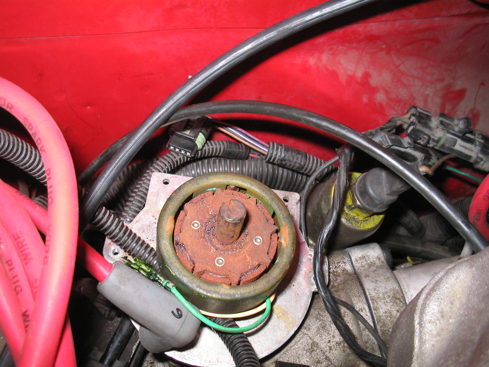

Reason I "quoted" you, I pulled ignition module and took to AutoZone. They hooked to machine and tested three times. Said it work good, nothing wrong there. As for the wires that go to it. I took the tiny bolts out of Ign. Mod., when I tried to unplug connector on back of it, the white plastic part of plug disintegrated in my hands. There was this greenish goo all over wires right at connection. Appeared to me to be some sort of grease or lube. Very sticky. I snapped a few photos of what I found in dizzy.
After removing cap and rotor, I noticed the center of metal part was kind of rusty looking. Also, the round thingy surrounding rusty metal part will slightly rotate and wobble a bit with force. Of course I wasn't doing it very hard so not to damage. Just an observation. What youz think?
Attached Thumbnails Its me again, New MAF sensor, getting Code 33-img_0012.jpg   Its me again, New MAF sensor, getting Code 33-img_0010.jpg   Its me again, New MAF sensor, getting Code 33-img_0013.jpg

Dude that sign looks awesome, I appreciate it. And I have good news. I know what your problem is. It is the Distributor. You need a new one.
That is why the car died in fornt of your house and why you are haivng these issues.
My Dad's 87 TBI truck has a 350. It would run ok when we were on the gas but kept dying at idle in drive or reverse. When I pulled the cap, all kinds of green powdery stuff, the connector on the back of the module crumbled in my hand as well
My Buddies 87 T/A, run bad and quit running. Fuel pump and Dizzy got that car at the same time. Tried to remove the reluctor to replace the pickup coil and the reluctor broke in our hands. Also had greenish powder. The powder is the pickup breaking down.
My current 88 IROC, would start run and die, start run and die, run like crap if I gave it gas. Pulled my cap, I could move the shaft by hand, the points on the reluctor had been worn down because of the wobble.
Alot of corrosion in all instances.
You car starts at first runs and then dies because you distributor is not giving all the correct signals it needs to because it is worn out. I know it is like $100 but I am 99.99% sure it is the problem and if the .01% chance it is not. I don;t think anything else could be done until it is replaced.

One other thing, if you look at the the points on the trigger in the first pic, you can see some of the points are worn down, that is from them hitting the contacts on the reluctor.

Yep, reluctor coil will keep ECM from controlling injectors and turning fuel pump on. However, why did he blew main ECM supply fuse unless FP is jammed????
Regarding dizzy - I have taken my spare small hat HEI apart for another troubleshooting post - here are the pics for reference.
Yep, I know this place can be addictive, but I like that way! Good night and sleep well - do not worry about XYL. She'll be happy once you fix your ride.

Hey RF,
You read the part about me blowing the ECM fuse, but that was a 10 amp. When I installed a 25 amp, taken from wipers, fuse never blew again. Would you still think F/P? Your test doesn't sound too involved or difficult, and I will give a try just to rule out.
So the larger round thing, surrounding the rusty middle part (on dizzy), is the P/C? Shouldn't there be springs and a bunch of guts (internal parts)? Mine doesn't look like the ones in the book at all. And I agree, it doesn't look in that great of shape. I'd really be disappointed though if I rushed out and blew a hundred or so bucks on a new dizzy, and have problem persist.
Now my final question. Can the dizzy just "instantly" go out? I have to keep reminding myself that the night before all this started, I drove car with no issues. Ran like a dream. Can the dizzy just crap out sitting overnight?

Yes, reluctor coil can go instantly or on rare occasion become intermittent. In just about every case that I have seen so far coil wire just breaks somewhere due to corrosion. Apparently it is a real problem for people living in harsher climates! Rust and green looking stuff are indication of moisture getting inside dizzy which can wreck a dizzy of time.
The ring like structure with slots on its interior is a magnetic field guide sorta speak. The reluctor coil is mounted below it - you can see it as it has white looking plastic cover. The rotor has magnets - and in your picture is very rusty looking. As it rotates the magnetic field which is present due to permanent magnets mounted on a shaft is being interrupted by these slots. Change in magnetic field causes change in induced current generated in the reluctor coil. Ignition module has an input buffer circuit that detects these changes and converts it into voltage pulses (DRP) which ECM uses to determine Engine RPM and to control injectors.
There are no weights, springs that use to perform timing advance. All timing changes are controlled by ECM, except that you must set initial timing correctly for F-bodies it is about 6 deg BTDC.

Yes, it can go bad all of a sudden. My dad's truck, same dizzy as our cars, went bad all of a sudden. I pulled the truck in the garage, did a tune up, alternator and fuel pump. And when I pulled it out it would keep dying at idle. I didn't touch the cap as we replaced that earlier. No problem of dying before, but after I put new crap on it, it started giving us fits. Put a new module on it and still no help. Replaced dizzy and it never ran so good.
And the dizzy in the book may be an older one. Ours is pretty simple. There is a bushing/bearing in the dizzy shaft and when it wears out you get the slop in the shaft. Then the magnetic piece on the shaft gets in to the magnetic points on the reluctor and wears down the pointed ends increasing the gap between them. A new dizzy has some friction when these touch. All my owrn ones had a greater gap, which can reduce the signal, which will not tell the ECM to fire the injectors.
I know it sucks, but My dad's truck came from South Carolina, My IROC came for Florida, and My friends T/A came from North Carolina I think. All those dizzy's looked similar to the condition of this one.
My Formula had 145K on it, was from Central Georgia and Alabama and the dizzy was clean and had little corrosion under the cap. And it had the original module still in it when it went out at 150K. So that goes toward RF's last post about climate.
I know $100 is steap. But even if the .01 % chance of this not being the problem. There is a 99& chance you will have problems shortly out of this one. But I am sure this is it. If it was my car, I would do it. Well, I have done it.....

ps sorry to hijack this thread, i too am looking forward to hear if you get your car running
Hey solaris_vii,
My advise would be to search the archives. This would not be the best spot to try to sneak in. Although, I really don't mind. I just think you would have better luck posting your own post with the most info you could provide. The peeps who are here to help, know their stuff. You would have a better chance.
If your car is doing what mine was doing, try replacing the dizzy. Worked for me...

Awesome, glad it worked out!!!!!As far as runninng issues, start with all your vacuum lines. I knocked my main line off that goes to the brake booster and was going nuts figuring it out.
Supposedly these cars like 8 degrees BTDC as well. Make sure your EST was disconnected. Check all other Electrical connectors just to make sure nothing came undone. Is your SES light on?

No SES light. Yes, I am glad it was dizzy. Thanks again. You were the winner! Next time I see you are 99.99% sure of something, I will listen...lol Not that someone else wouldn't of come to that conclusion, you just beat them to the punch. I will go over entire engine compartment tomorrow. Recheck everything. One thing I did notice is there is a small amount of antifreeze coming from intake manifold right behind alternator. Noticed it the first time I drove car after new head gaskets. After my ride tonight, I didn't see any. Should I be worried about this? I checked my oil and no milky coloring. At first, I was worried about manifold leaking on inside. Do new manifold gaskets have to seat? I mean, will they like swell over time and maybe fix on their own? I'd sure hate to have to tear top of motor off again, but if I have to, I have to.

Also after setting timing with EST disconnected the SES light will be lit. (Code 43 IIRC will be set) which is normal. Clear TDC by disconnecting battery for about 1 minute. The ECM will have to re-learn fueling table (BLM) since all previous compensation is now gone. Its ok, just drive at various speeds, traffic conditions and in about 25 miles CM will have sufficient compensation re-learned.
Vacuum leaks are always a pesky problem to resolve. Congrats!!
