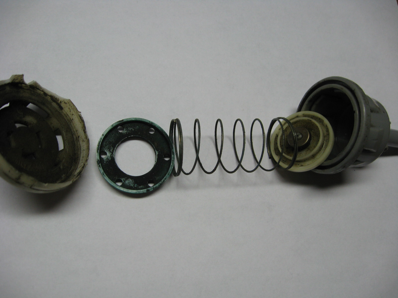

Old Apr 20, 2009 | 03:10 PM
Vortex91's Avatar
Joined: Aug 2004
Posts: 180
From: Woodbridge, ON, Canada
Car: Camaro RS '91
Engine: 305 TBI
Transmission: Auto w/ TransGo shift kit
Re: Gas smell coming from the car - help
Attached are two shots of the valve assembly.
One shot show the valve disassembled. As you can see there isn't much to it.
There is no carbon filter or any for of filtration.
D.
Attached Thumbnails Gas smell coming from the car - help-img_1316.jpg   Gas smell coming from the car - help-img_1317.jpg
Don't know if I have correct information....but my '91 camaro did and does the same thing...I researched and asked everyone I could think of...I got a response from a GM mechanic at the dealership who said that it was actually normal, or kinda normal anyway.....what happens is the tank builds up pressure usually from heat from the road and especially the exhaust system...instead of the tank getting more and more pressure (which is dangerous), it releases excess gas fumes through that valve assembly/vent you have pictured about. I had the same problem and it bugged me...so when I put my new exhaust system on, I put a smaller muffer on (went from flowmaster to aerochamber) and left a little bigger gap between tank and muffler....also I had the whole exhaust system, including muffler ceramic coated to keep heat down...then I also took off that small tin heat shield under gas tank, had it ceramic coated, and then attached some heat shield material to it (like muffler wrap, but one side has sticky tape to stick to something, get it in Jegs or Summit)....anyways, I haven't smelled any gas fumes since...and also I noticed when I open tank to put gas in it, there is less pressure in it. You know what might also help you that I noticed helps before I did all I stated above.....keep tank at least 3/4 full....the gas doesn't heat up and turn to fumes as fast....anyways..there is my two cents...hope it helped some....

Re: I think I found the solution
Originally Posted by Vortex91
So after jacking up the car and checking things out I think I found the problem (and the solution).
There is a "vent" attached to the gas tank thorough a rubber hose and I figured this is the only think that could alking to a guy from a parts store I decided to replace.Here is the theory behind this "vent": gas vapors build up in the tank and this "vent" is nothing more than a pressure relief valve (spring loaded) with a carbon filter in it to neutralize the smell.
The GM part number is 10033125 and the description is Valve Asm (as per shipping papers). It was $63.79 Canadian including taxes.
I've replaced it today and now I have to see if this really did the trick.
If anyone wants a picture of this valve let me know and I'll upload one.
D.
sent a pic of the vave be greatly appreciated also did your car ever run funny like cut out and run odd when valve was bad
