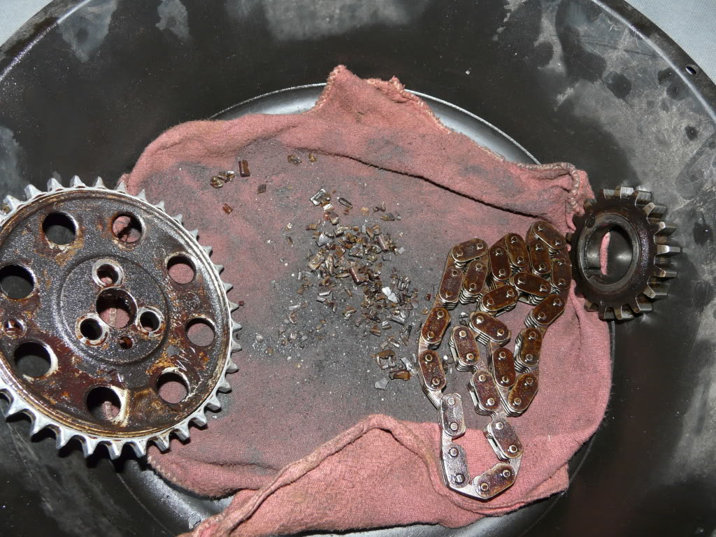

Ok for those who want to know. My engine is out of an 86 IROC. Its a 305 TPI. What I found in the pan was a pile of plastic/nylon. Plus a lot of sluge. This engine had set since around 2005 till now. It supposed to be around 60,000 miles on it. As in my earlier posts I was wondering if GM was still using Nylon teeth on the CAM Gears for the timing sets. Well, They definatly were. I'm pretty surprised that it didn't skip a tooth as loose as the chain was. As I turned it over by hand to line up the marks it almost jumped twice. (also explains why I could never get the timing right)
Part of the Nylon is still on the cam gear but not much is left as you can see. You may also see that the mark for the cam gear is still showing in the plastic/nylon on the gear (go figure). Anywho, this is what I took out. It is pretty nasty looking.

I pulled the front main cap to check a bearing as my oil pressure quit and that was the whole reason for the tear down. The bearing looked as if it had hardly any miles on it. Still showing the babet(sp) coating. (Really weird) I would say that it hasn't ever been apart though. Guess I got lucky. The LT1 I got will just get put on the back burner for later.
