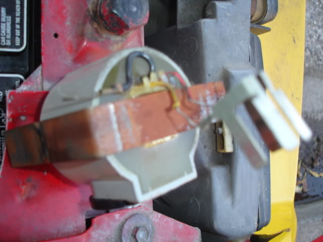

thats my old one but my new one came with this little metal thing i didnt put is this what your talking about?
