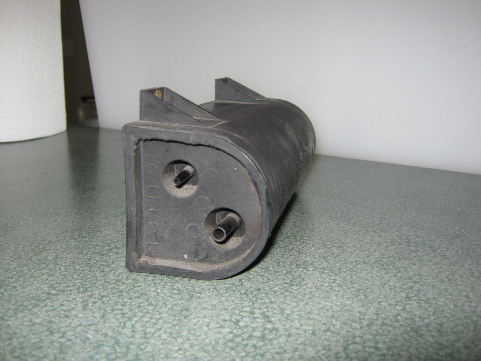

Can somebody please tell me what this part is. Thanks

I think that's the vacuum cansiter for the hood flaps on the early Z28's. Is your car a Crossfire car?

crossfire, reason an 83 Corvette doesnt exist

My guess also would have been a vacuum canister.

My car is a Z28 with the stock 305 tbi and no crossfire. Its not a huge deal seeing as it was'nt hooked up completely anyway. So obviously not anything crucial. Heres some better pics for the hell of it.

My 82 Z28 is (was) an original Crossfire car and had that canister. It had a vacuum line going to the hood (or the thing that controls the flaps....been awhile since I pulled it out). My 83 was an L69/5speed car, no Crossfire...didn't have the canister.

Well I did some more research and found that in my car it was used as a reserve vaccuum canister for the heat and ac controls in the dash. I guess it helped keep an even temp inside the car when the engine was at WOT. Any way I dont think I'll be putting it back in for now. Thanks for all the help!!
