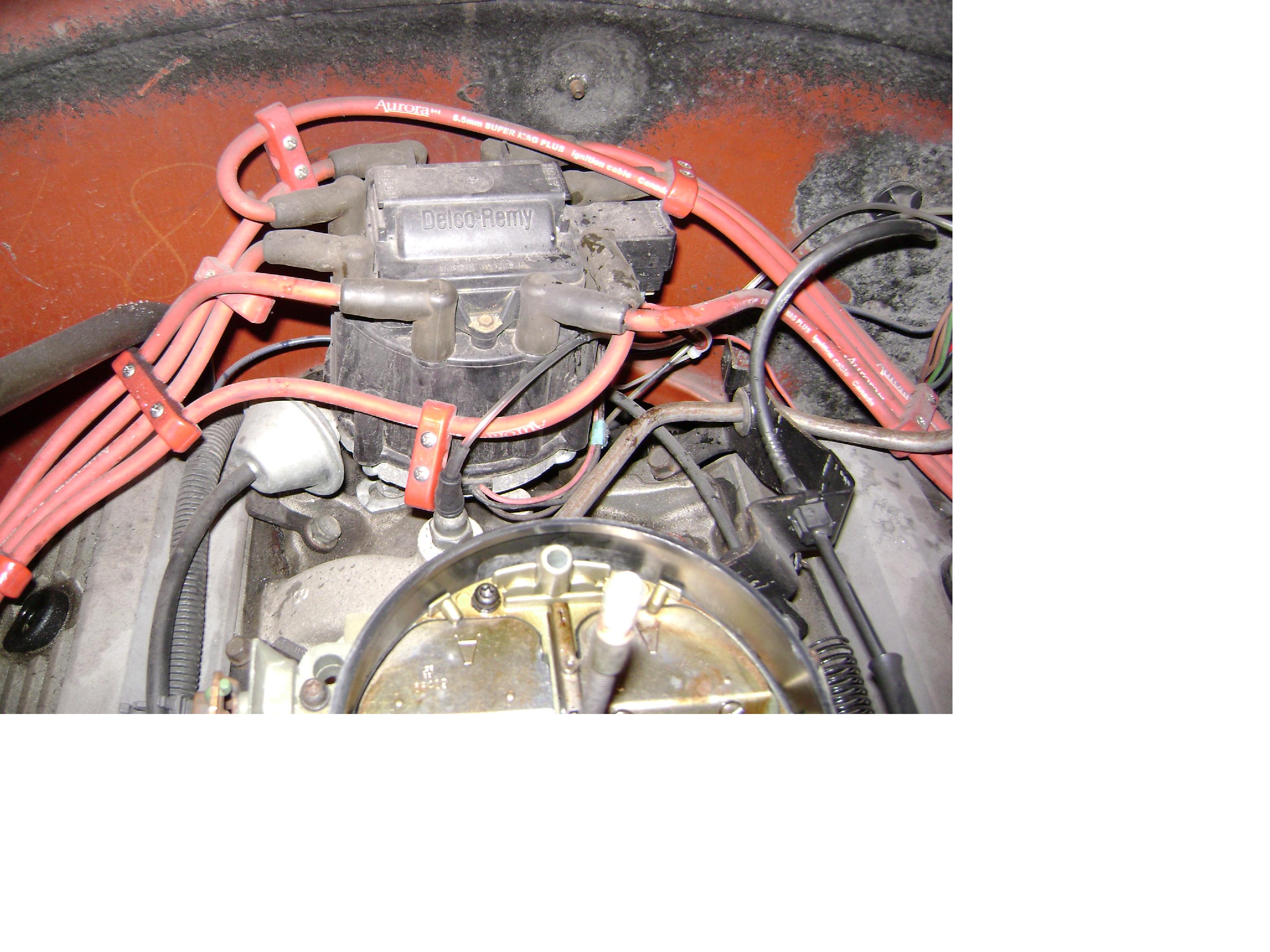

Yes my engine really needs a bath
That wet crap is just water
See how my 1 and 8 straddle the center line of the carb?

Yeah that was the way I wanted it originally, but the way it is turned should have no effect on the timing, as long as it is timed correctly....?

Umm, when you turn it, you are affecting timing. You turn the Whole Assy to get your timing where you want it.
Having it installed either correct or 180 Degrees out is not what I am getting at.
The way you have it wired, #1 and #8 after the block, like mine, is good.
Turn it counter-clockwise like mine and try to run it.
When you turn the Dizzy Cap clockwise, it follows the direction of the Rotor, which in turn causes Retardation.
The more you turn it counter-clockwise, the more advance you get.
Your timing is probably out by 10 or more degrees Retarded with the pot turned past the end of your valve cover.
That's why, when I saw your pics, I said it's Way out.
Just try to turn it like my Pic and start it. It won't hurt anymore than what you have already done @ WOT.

Oh, and by the way, I was so embarrassed with the Pic I posted last night, I pulled it into the shop today and washed the motor.

Re: Issues with new motor, doesnt want to run.
I have decided to just bite the bullet and drop the tank on wednesday. Wish me luck.

It Runs!
Dropped the tank, turns out that the return line, by the base of where the fuel pump pickup is, was totally rusted shut. FULL of rust, so bad it didnt even let air through. I cut the line a little higher, ran rubber hose down to where it dumps originally, put everything back together, adjusted the fuel pressure to 5psi, and guess what? Cranked FIRST try, other than valve chatter, a little smoke, and nothing being tuned, she runs!!!
Thanks for your help everyone!

And now, It DOESNT run.
I am at my wits end with this damn engine. It was running, not well, but runnning today, hooked up the timing light, and the timing light wouldnt blink with the engine running, and everything hooked up right (New light, used on a buddies camaro, and works fine) I moved the wire that went to the plug wire (on the timing light) and the engine just shut off, that fast. Now it wont start at all.
It seems the more time and money I throw at this car, all it does is shovel crap right back in my face. I dont want to have to sell it, I love this car and wouldnt trade it for anything, I just really need help with it.
The only ideas I have:
-Defective distributor
-Arcing plug wires (a few are burned)
-Its cursed (lol)
Old Mar 21, 2010 | 01:37 AM

Replaced plug wires today, same results.
Pulled #1 plug to check on timing, wadded up tissue in there, and when the tissue came out, so did quite a bit of fuel. It seems that the carb is shooting a little bit of gas out of the carb now as well.
Is there anyone local who can come and help me? I can give you a bit of money, or some 3rd gen parts, or whatever, this thing is mind boggling.

I fixed the fuel pressure issue, It holds steady at 5psi.
The wire I moved was the wire from the timing gun, the one that clamps the #1 spark plug so it can read the timing. I believe this to be un-related, but I could be wrong.
I have had the tank dropped before, fuel was awful, atleast 5-6 years old. Its been a daily driver since thn though, without issue.
I KNOW that the distributor is NOT 180* off, I have set / checked it 7 times.

How did you hook up your new distributor? Is it a stock replacement? The CC distributor runs off a resistor wire. I would recommend hooking a constant 12v straight off your battery to your new distributor and see where that gets you. Is it backfiring thru the carb or out the exhaust or neither?
No need to buy new plugs make sure they are gaped to .035" and dry then put them back in.
Have you set for float bowl levels? If gas is leaking out of your spark plug then check your oil, does it smell like gas? If it does then your leaking gas from your carb.
once you verified everything above have someone sit inside the car and crank while you rotate your distributor slowly. Be sure to give the starter a rest so you dont burn it out.
