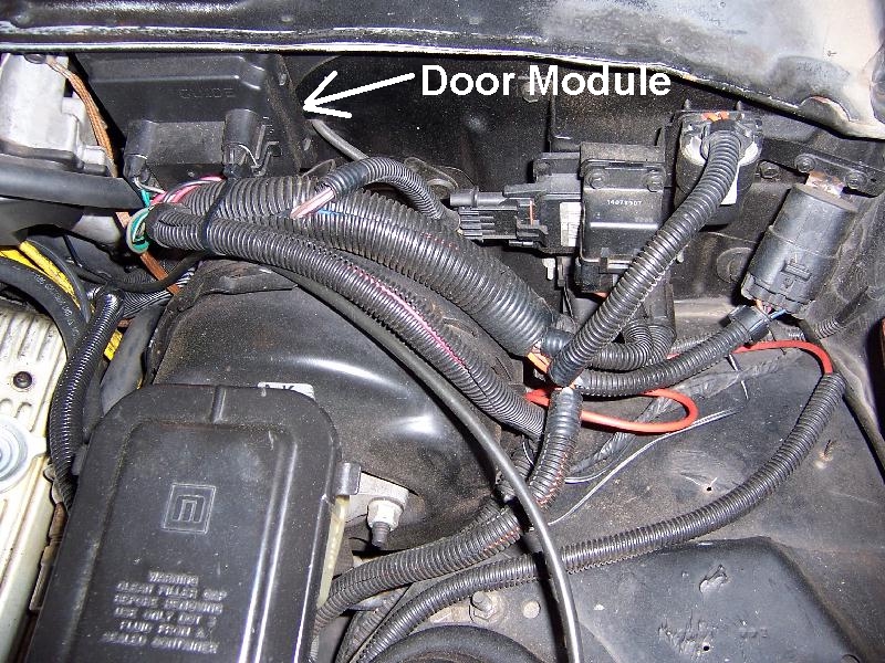

Common problem. Check the terminals in the harness that plugs into the headlight door module. They get loose and overheat creating a bad connection. ~or~ The module may be going bad.
If the motors just spin and the doors won't raise, the biodegradable bushings in the motors have turned into breadcrumbs. Hawks Third gen has the Delrin bushings in a "get-well" kit that fixes them forever...
