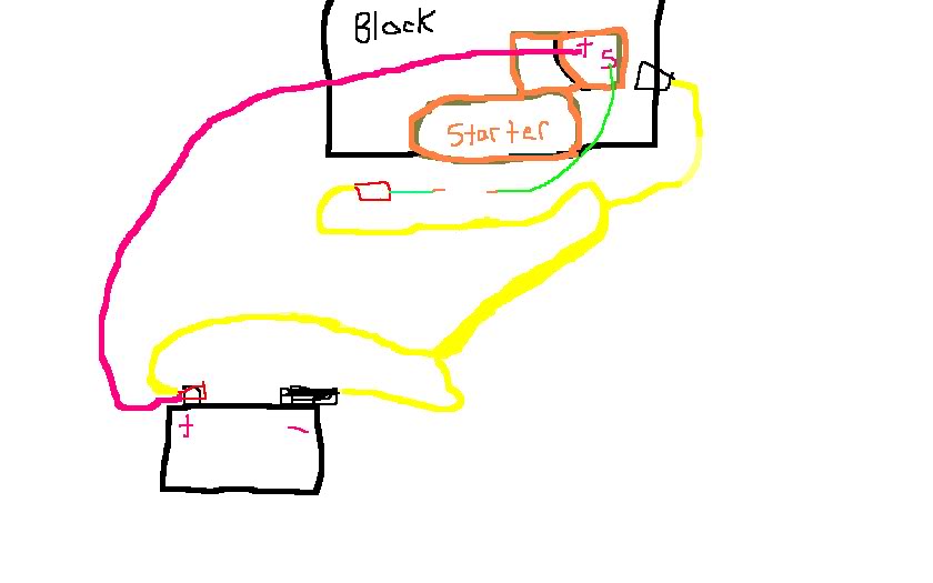

I want to start the engine soon to make sure it runs fine before putting it back in the car. I'm using a distributor and carburetor. I go by this little diagram I made to turn the engine over:
Do I have to get that pink distributor wire and just run the other end to the positive battery terminal to make it spark? http://cgi.ebay.com/ebaymotors/ws/eB...657+&viewitem=

Yup
Don't need the pigtail though, a 1/4" female flag connector fits

if ur gonna test it yes, but needs to be hooked to a keyed power source once in car
