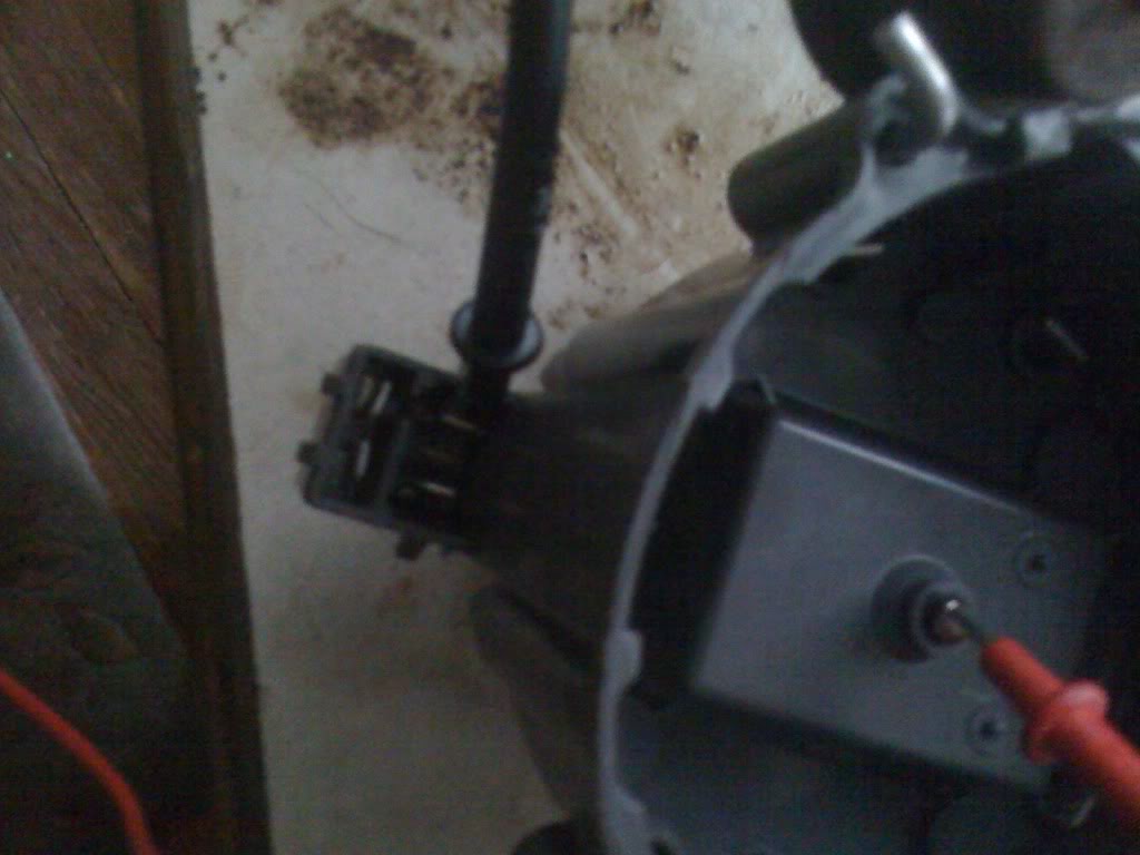

I'm measuring the ignition coil secondary resistance between the TACH terminal and the secondary terminal (that rotor button thing on the bottom of the cap).
Then the ground terminal and the secondary terminal. The ohm meter only says "1" on both tests I want to know why its not saying anything. It's supposed to have around 15000 resistance for both right? I'm at the end of my rope on solving this. I mean I guess I could just get another distributor that's new but this thing is bugging the crap out of me.

That's not the tach terminal.

You're right, the picture is wrong. I just did the test and I'm not getting a reading though still. I don't know what else to do it doesn't make sense to me . I got the meter set to 20k, nothing. I'm pretty sure I'm doing it right because I can get a .7 between the BATT and TACH.
